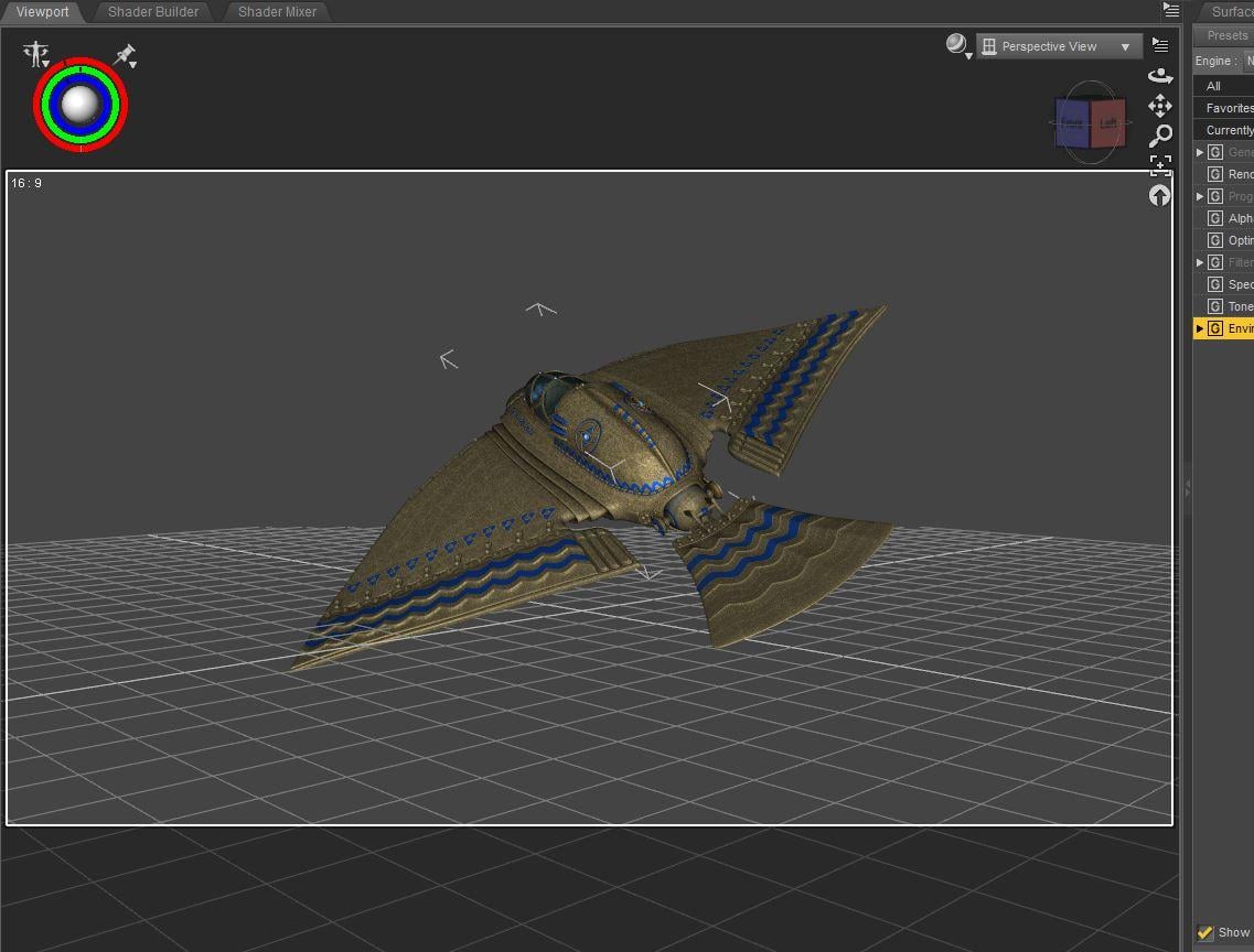

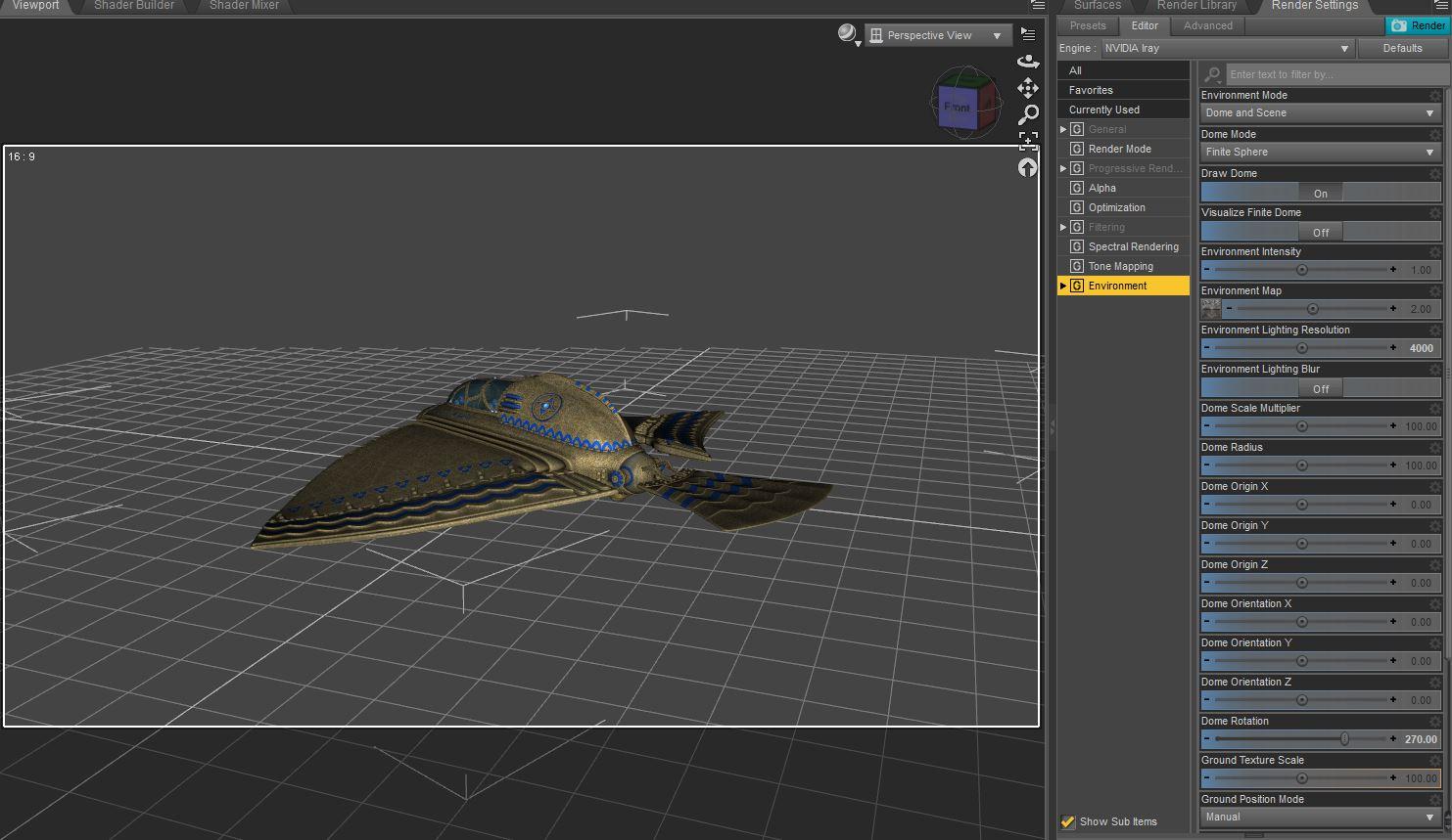

  • BeeMKayBeeMKay Posts: 7,019
    edited October 2018
    You need to set your render settings to Iray, Dome&Scene. It will not show up in 3Delight.
    Do you have any of the suggested HDRI-packages? For example, I have used https://www.daz3d.com/epic-skydomes-cloud-haven-hdri/
    You load the HDRI though the icons in the Content/Smart content. They usually will set up the secene for you.
    I loaded my plane and positioned it. In my case, I switched off the ground floor because of the shadows, but you can leave them on if the scene requires it.
    I also moved the camera a bit.
    When I start an Iray Render now, the HDRI gives me light, and provides the background imagery, as long as you keep the setting "Draw Dome" switched to "On". Otherwise, you'll just get the light.
