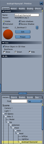

    First off, expand the figure's hierarchy in the Instances tab on the right side of your screen. When you load the hair, drag the icon from the Object Browser and drop it on the head in hierarchy list. The hair cap should load at the proper location.

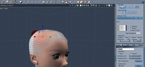

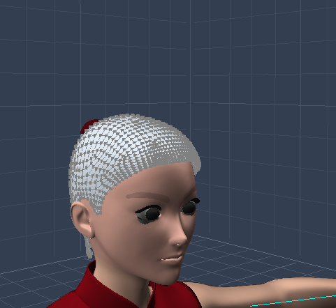

    The other option that will be a bit more exact is to edit the mesh of the haircap. This sounds scarier than it is. This will work best if the figure is in the standard T-pose and the hair cap is parented to the figure's head using the method I described above. If it needs adjusting up or down, forward or backward, or front and back, do that the best you can. The figure should have the morphs applied for an accurate adjustment.
    Now with the haircap still selected, click the wrench icon at the top left of the screen to enter the editing mode. The haircap should now look like a mesh and some of it may be hidden by the figure. That's okay. The wrench icon will turn into a hand icon. When you're done, just click the hand icon.
    With the standard selection tool selected, on the right side of the screen you should see some tool options. Click the little dot next to Soft Select. now click a poly on the hair cap. The red indicates the poly selected, but you should also notice as it gets further away from the selected poly the color gradually fades to pink. If the range is too great, you can adjust the influence of the soft select by using the slider below where it was enabled.
    You should also see arrows indicating the directions you can move the poly. Move it in the direction needed and the main poly will move, but so will the pink colored ones, with the furthest from the center moving the least.
    If a Poly is hidden by the figure, just click in the approximate spot you would like. Carrara will ignore the figure as you are not editing it. If you use the manipulator to pull the poly out far enough, you'll eventually see it poke out of the mesh. Wherever the mesh of the haircap and the figure don't line up where you want, push and pull the polys in that area until it looks like it fits.
    When you're done editing, click the hand icon. To hide the haircap, select it, and uncheck the visibility box under it's General tab. The hair will still be visible in the render.
