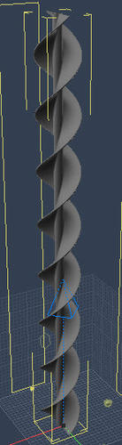

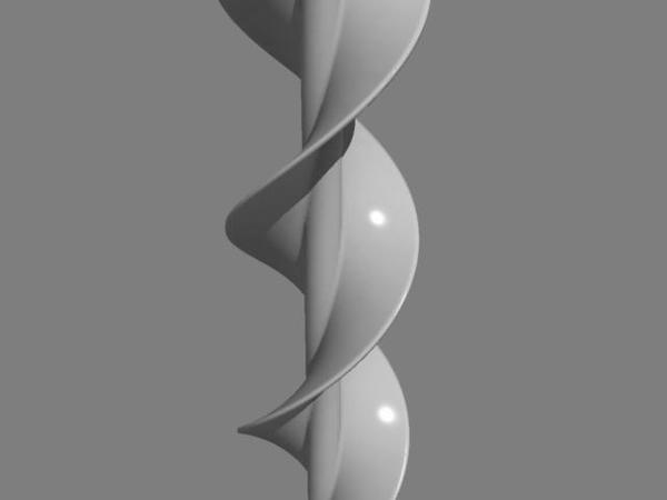

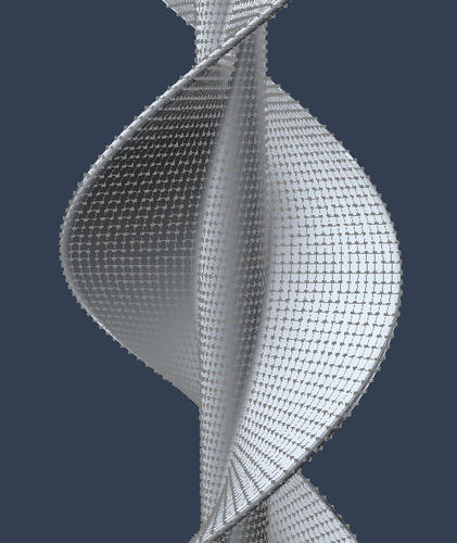

    I did a search for a "conveyor screw" (not sure if it is the correct one I found/used for this) and made a quick example in Carrara vertex room:-
    (I did not finish the ends)
