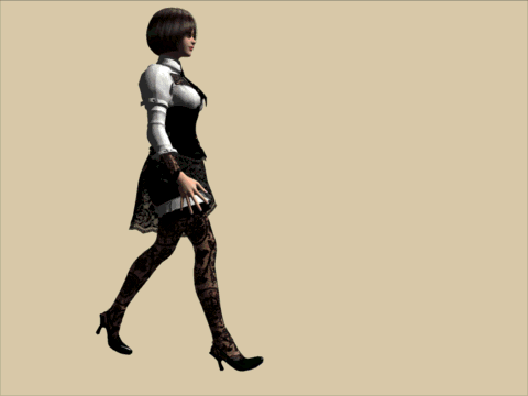

    Funny you should post this topic! The last couple days I was working on creating a simple walk cycle for A3. I wanted two cycles. One with heels and one without. I wanted to create and save NLA clips for future use. When I created the clips, I excluded the feet from one so I could still pose them- this is the clip I used for heels. The other one has the feet included, this the one for flats. I need to test in a more complex scene to see how both clips work.
    Here's some animated gifs. For some reason they play much slower than the .mov files. The one with A3 in the school girl outfit has flats. The other is the heeled version.
