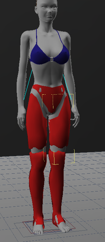

    Rashad (and Spooky, and all others who are curious), Carrara softbody physics can do quite well at emulating cloth. I'm guessing all cloth is derived from softbody physics, though not all softbody has to be cloth (I'm thinking of stuff like jello for example), I think it's all in the settings chosen as to what it will look like.
    The problem up til now is that while you could drape cloth on a static figure, in animation there would be pokethru and collisions and other pandemonium. Stringtheory came up with a method that works quite well to overcome this (looks like historicaly Marcus Severus also arrived at a similar workaround) which Diomede has very eloquently explained above. To put pictures to the explanation, you basically have to turn off all collisions on your actual character and then use an invisible conforming softbody vertex object that conforms to the shape of the character's body and is soft attached to the character to move with it's bones. Here's an example of what we've loosely been terming the 'undersuit' with visibility enabled so you can see it (it's the red part):
    297 x 680 - 102K

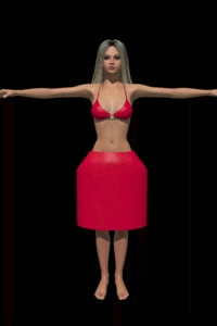

  • JonstarkJonstark Posts: 2,738
    This isn't a great rig, or even a very good one, and it's only covering the lower part of the body, but the idea is that this invisible undersuit which is a soft body, is the only part of the scene the collides with the actual cloth softbody. It works well, here's one of my earlier tests as an example:
    200 x 300 - 2M
