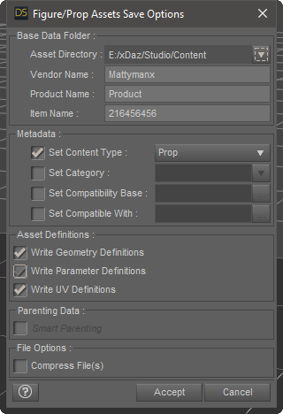

    Asset Directory.
    This tells you where the actual Data is being saved.  You will still need the props folder that you are saving to but the Data folder you have to copy over as well.
    Make you life easier and make sure the vendor name is filled out, plus all the parts should be under the same product name.  But each part should be named differently of course as to not overwrite each other.
    When I make a product, I have a seperate working folder where I save my new product too so that it is not mixed into my main content library.  Then when the props are all done, I copy the data folder over as well.  Btw, you dont copy the actual folder called Data as that contains ALL your files for all you installed content in Daz Studio.  Make sure you properly name your content so you can find it later in the Data folder.

  • Thank you for your reply.
    I am only copying the folders that I saved my props to and I did copy over the data folder (only the folders associated with my props). My DAZ Library/data/Hoplite490/CAR.
    But a Data folder should be created when the prop is saved as a figure/prop asset, for instance My DAZ Library/data/Hoplite490/CAR was created when I saved the prop. When I originally saved the props, a separate folder was made for each prop under My DAZ Library/data/Hoplite490/CAR as well. But now, the folders are not getting created.
