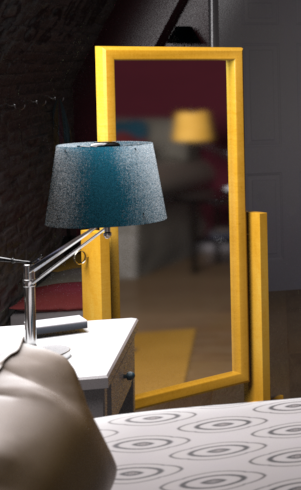

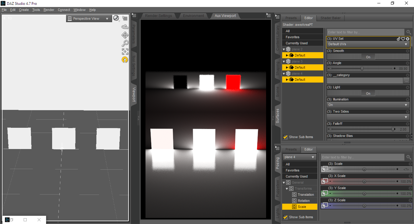

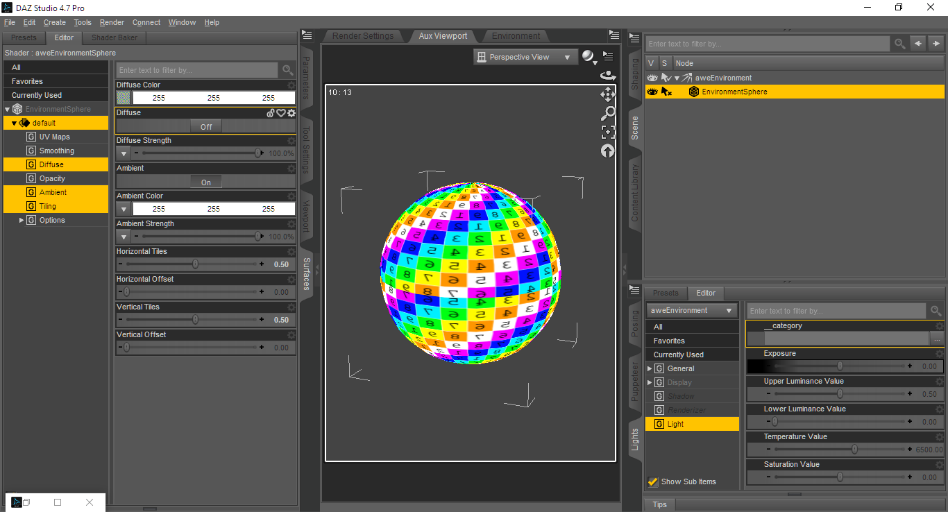

    AWE AreaPT in action

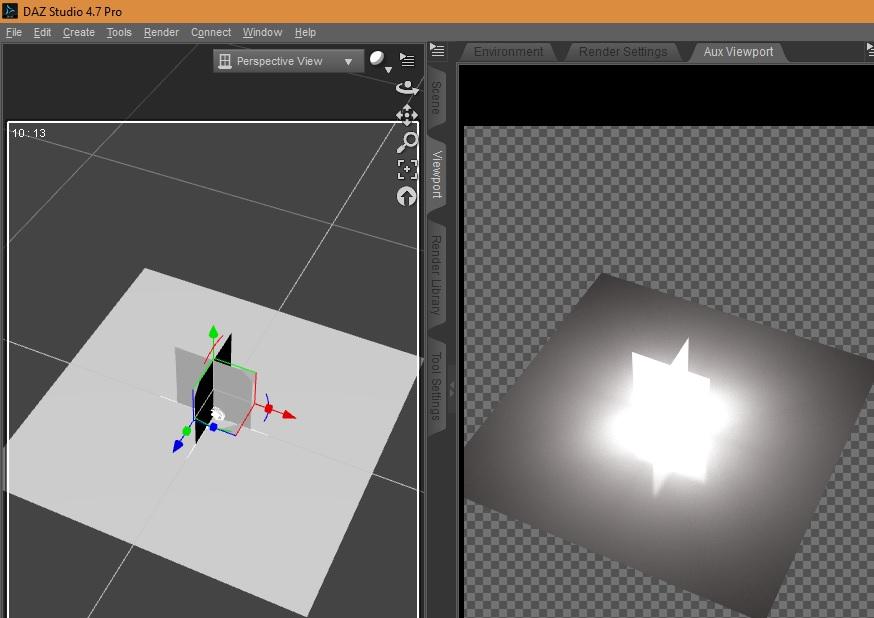

    If you need to simulate a certain light shape, use AWE AreaPT with the included polycount-optimized emitter figures which you can shape into various shapes by manipulating the figure's child bones.

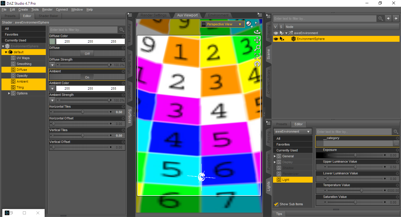

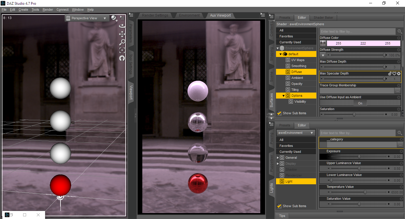

    The AWE Environment Sphere shader compliments the included, new environment sphere. This environment sphere has proper normals facing inside the sphere, so textures have correct orientation.
    Viewed from the outside
    From the inside
    You can even rotate the texture across the sphere just by changing its horizontal offset values.
    The adjustments you've made will be visible in the viewport and they can even be done when you're doing a live rendering session (IPR).

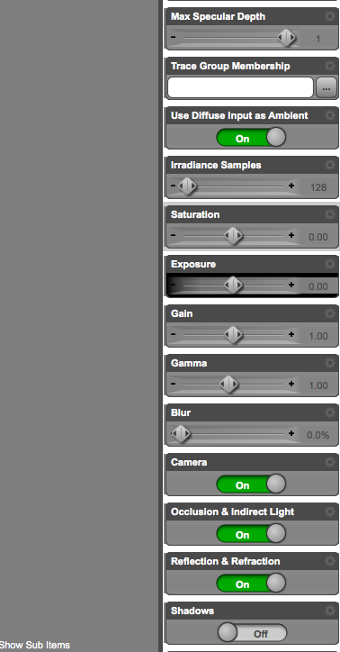

    The AWE Environment Sphere comes with extra options to adjust exposure, saturation, gain and gamma of the IBL texture you're using. You can even apply a blur to the texture without modifying the original texture. Since it's geometry, you can even use multiple environment sphere in your scene.

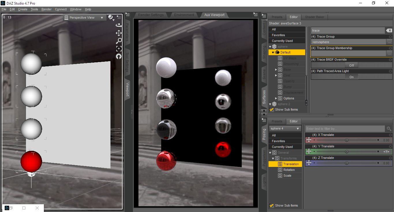

    Both AWE AreaPT and Environment shader support trace group memberships, allowing you to use light linking (for AWE AreaPT) and selective raytracing (for AWE Environment Sphere)
    Feel free to post questions or comments on AWE Shading Kit in this thread. If you would like to know more about AWE Surface, you can post it here or on the thread linked above.

    AWEAreaPT Intensity Scale and Intensity Scale Offset settings are based on Exposure Value (EV).
    • Incrementing -/+ 1 EV will decrease light intensity by half or increase intensity to 2x.
    • For example a 100% intensity with 0 EV, will be 100%, -1 EV will be 50%, with 1 EV it will be 200%.
    • Distance wise, 1 EV corresponds to roughly increasing/decreasing the distance by 150 cm below 500 cm. Use 300 cm beyond 500 cm.
    • EV scale is in energy per unit scale, so the larger the emitter, the more energy the light emits.
    • In relation to emitter size for area/mesh lights, 4x the total area scale, 1/4 of the EV.
    • For example, with a plane of 1x1 m with a uniform scale of 400% (400% in x, 400% in y), you need to set the EV to 1/4 of its original value.
    • If you only change the scale in one axis, say by 400% (100% in x, 400% in y), then set the EV to 1/2 of its original value.

    To simulate sunlight with an area light.
    • Use a 1x1 m area light emitter. A sphere with 12 segments and sides should be good enough. Make sure it doesn't use subdivision.
    • Change the scale to 25% and make sure it's somewhere around at least 1000 cm (typically I use 1075 cm) away from the point of focus.
    • Point of focus typically will be the center of your scene. For AWEAreaPT light sets, this will be the pivot node.
    • Set EV scale to 11, for example by setting Intensity Scale to 8 and Intensity Scale Offset to 3 (8+3 = 11).
    • Alternatively with 14 EV, scale should be 12.5% and distance 2275 cm (1075+1200 = 2275).
    • Another alternative is using Intensity Scale to 0, Intensity Scale Offset to around -7 to -7.25 and setting Falloff to 0. This setting works best to get more fill of the environment and very hard/sharp shadows.
    With the updated AWEAreaPT, you can actually animate between the above settings if you like.

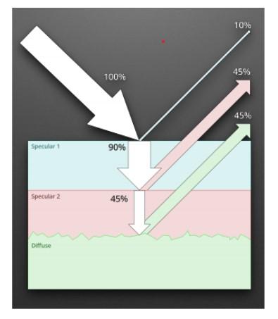

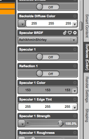

    Specular/reflection for skin
    • Enable at least one specular/reflection lobe on the base layer.
    • By default, the second specular/reflection lobe is enabled.
    • Set the lobe's specular strength to 35%.
    • If you use specular strength textures, make sure to enable 'Normalize Specular Map'. It will make things consistent.
    • Typical index of reflection (IOR) for skin will be between 1.35 and 1.6.
    • Set roughness to a value of 20% for dry skin and 10% for a more glossy skin.
    • Change either the IOR and/or roughness to control specular highlights, keeping specular strength the same if possible.
    • To simulate fuzz/velvet around the edges, make sure to enable Glossy Fresnel on the base and set it to 22.5%.

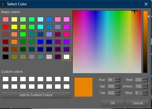

    • For less saturation, decrease the saturation color of the subsurface absorption color by half. For example, 255 will be 128.
    • For even less saturation after decreasing saturation color, increase the hue by 1.5. For example, 34 will be 51 (1.5 x 34).
    • More saturation, decrease the hue of absorption color by half. For example, 34 will be 17.

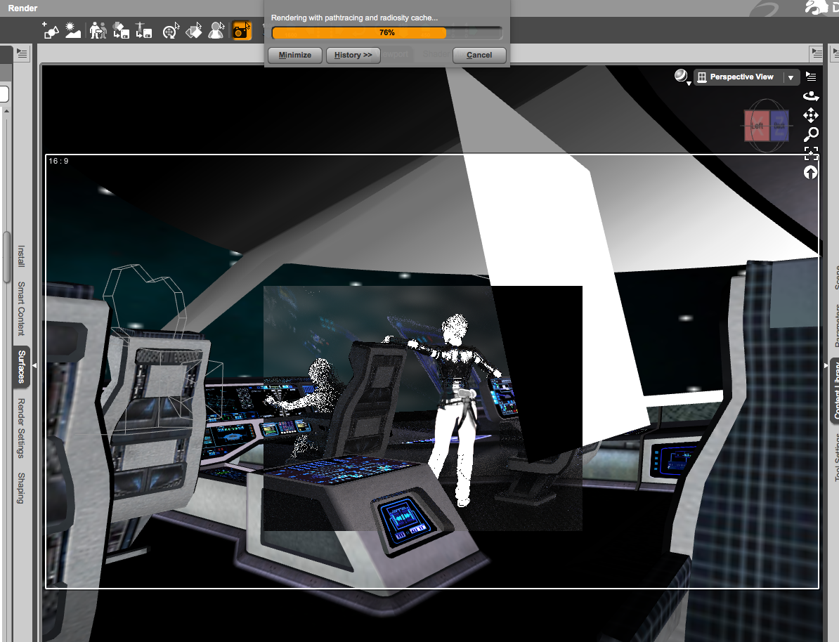

    i have a question when using an environment sphere and an area light from the kit (with headlamp blocker), i have issues to light the environment (very dark).
    This does not appear with iblmaster and an area light

    Try loading the quick start scene and rendering it. If the render came out pitch black, the files aren't installed properly.
    The quick start scene should give you an idea on how to setup the environment sphere and/or the area lightsets/emitters. Basically, if you want to use only the environment sphere, you need to plug a HDRI to the environment sphere shader. Something like what you can see in the surface section in the screenshot below.
    If it still ends up very dark, you probably need to raise the gain or exposure of the HDRI. I generally just start an IPR session and change the exposure value of the environment sphere until I get the amount of light I wanted. If you want slightly more GI on objects, you can raise the exposure on the AWE Environment Light (the parent node of the environment sphere) to something like 1.
    If you just want a diffuse environment, turn off ambient and enable diffuse on the sphere. You will need to load at least one light.
    Post edited by wowie on

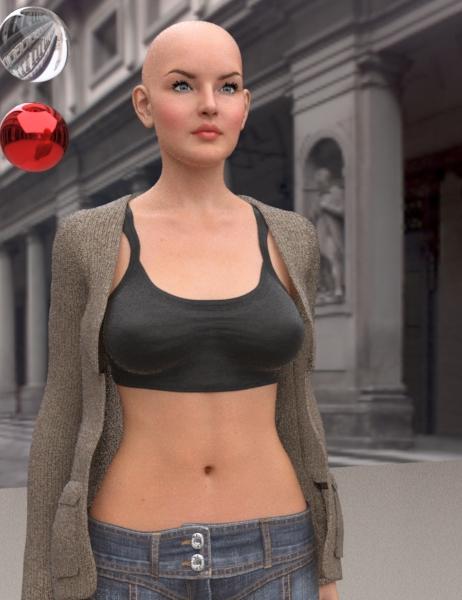

  • ArtiniArtini Posts: 10,920
    edited October 2018

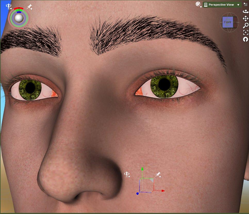

    Is the skin and the hair is suppose to look like that, or am I missing something.
    It is just the awe starter scene with added Sasori - https://www.daz3d.com/sasori-for-kenji-7
    Are we suppose to just double click the presets with materials?
    Or shall we ctrl click and choose "ignore"?
    1280 x 1080 - 305K
    Post edited by Artini on
  • MollytabbyMollytabby Posts: 1,163
    @Artini I'm doing something similar in that I'm using the start scene as a jumping off point for learning how this works. In my case I've selected the figure and in the surface settings applied the scripts that are included under 'skin'. I've no idea if I'm doing it correctly but I am getting a nice 3Delight image when I render rather than a sparkly one.
    Ok, thanks. I have also applied the preset for Genesis 3 to Sasori,
    but why am I getting the same sparkly skin on Genesis 2 Female, that was included with the start scene?
    I have not changed the settings of her at all.
    On the viewport or on the render? If it's on the viewport, that's because the preset does not override the strength value of the 1st specular lobe, although the lobe itself isn't enabled.

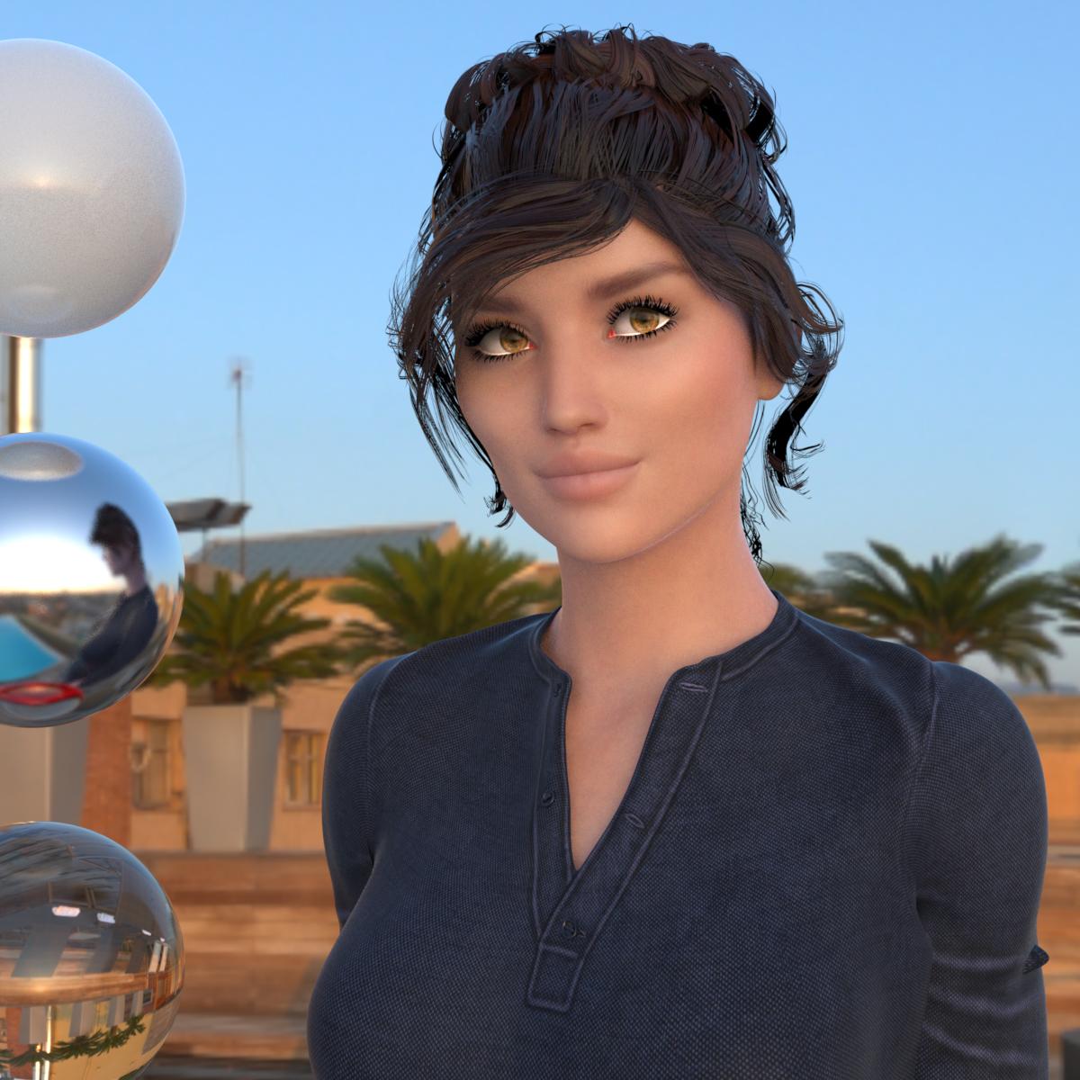

    edited October 2018
    Ok, I think, I got it. ----- One need to use scripted 3Delight.
    Below is Victoria 5 Supermodel render. She is happy, that I have found the solution.
    Rendering Time: 4 minutes
    1280 x 1080 - 219K
    It was on the render.
