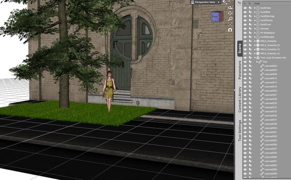

    ok I had to put it back together hope this is what you wanted....
    316 x 876 - 160K
    1407 x 869 - 987K

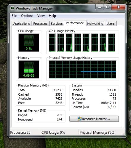

    Hmm... I see nothing that leaps out at me. What is your RAM use with it just Loaded?

    Could it be per chance be the tree and the grass? For example, I have 8gb ram as well.. and some plants/flowers/trees etc takes a Load of memory, if I put in one of LB's mighty oak in the scene, it slows my computer a Lot, some of the flowers are like that too.
    Perhaps it's something similar when it comes to this tree or the grass? just thinking out loud here basically, in the off chance it might be helpful :)
    Also, on your render progress earlier, it said osmething about compiling shader.. so what shader are you using? As Jade said earlier, some shaders a killers when it comes to ram *smiles*

    Reading minds now are we? But I just used a mesh grass a full prop set and the heart of the matter tree in a render. I'm thinking one item here might be causing a RAM leak. That's when Ram use starts climbing after it hits a peek for a bit.

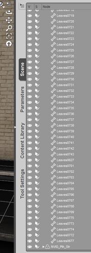

    ok I hope I did this right

    I remember when I started using 4.x I would get crashes immediately when the render started. Now, this may be a shot in the dark, but it worked for me, go to your render settings->advanced scroll all the way down and click the restore default settings button. It worked for me.
    Also, just a tip, That is a lot of grass and leaves. Use depth of field and background images when you can't render distance.Look through your camera setup and remove any thing that is not going to be in the actual render or do multiple renders and put them together in post.
    If those fail, try removing objects one by one and rendering. Maybe one of the objects is causing a problem.
