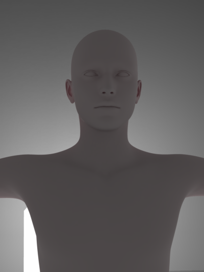

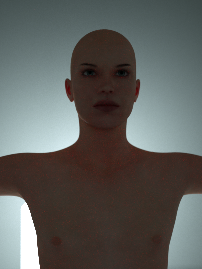

Hey, I love Carrara, it's definitely tremendously powerful and my favorite app by far, but if there's one thing that's driven me nuts over the years, it's trying to figure out Subsurface Scattering (SSS) in Carrara.  I'm talking specifically here about SSS for human skin, for daz-sized characters, that looks decent.  Carrara has SSS from way back before it was cool, so it seems a shame that the controls are so dang hard to use and understand, and to get good results.
I've bought every single product out there that has SSS settings for skin, and don't get me wrong  they are all workable solutions, but one thing that's surprised me is how wildly different the SSS settings and approaches can be between vendors.  These PAs are world-class Carrara experts like PhilW, Ringo, BTL, DimensionTheory, Fenric, etc, yet when it comes to SSS they all have very different approaches.
Every so often, I come back to it, fiddling with dials and trying to get that 'magic' result I'm looking for but never reach.  So I thought maybe this subject deserved its own thread, where wiser, smarter, and more talented artists than I could chime in to give tips, feedback and criticism, to see if it's possible to zero in on what the ideal settings for skin SSS might be.

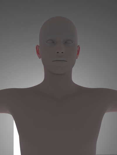

To start, here's my latest setup, do you guys think it's a good idea or am I just stumbling in the dark here?
It's dead simple:  I plopped a Genesis figure into the scene with absolutely no shaders except the standard 'gray' that it comes with, consolidated all the shaders so there's only one shader on the Genesis that controls everything you see.  Then I put a standard cube in the scene, made it bigger like the same size as a room, so that the camera and Genesis were inside a enclosed space, then a 2nd cube shrunk down a bit in size and right behind the Genesis.  Then I changed the texture of the 2nd cube so that it was glowing at 2000%, so that it will be the only light source in the scene.  Here's a screenshot of the big cube from the outside, then making the big cube invisible for a pic of the inside setup:
The camera is zoomed into the head area, and the whole focus I'm looking for is the ears, I want to see them 'glow' with SSS from being backlit by the glowing cube.
I have figured out how to do what I consider to be pretty decent SSS in the Octane plugin, this is not my own discovery but after studying several different Octane tutorials and then 'porting' the knowledge over to Carrara.  Although the thrust of this topic is to figure out SSS in the native engine, I did the Octane renders on the same gray Genesis as a reference point for what I'm aiming for, and so I'll give a brief instruction on how to do SSS using an Octane Material shader in Carrara.  Basically you need a Mix material where half of it is Diffuse and half is Glossy (50/50 split) and you only do SSS in the Diffuse channel because Octane shaders in Carrara are really really sensitive and putting the same SSS in both channels will result in too much SSS effect.  You can also do Diffuse and Specular, or two different Specular  channels as part of the mix, but the point is you only want to put SSS in one channel and make that channel's strength no more than 50% of the result.
The parts of the Octane shader that matter to the SSS are the Transmission, which should be set to a red color (I chose Hue: 0, Lumin: 50%, Saturation 100%) as this determins the color of the SSS effect, then the Medium channel which should be set to 'Scattering' as the type, and should have Absorption as an RGB color set to black (H: 0, L: 0, S: 0), and the Scattering channel should be an RGB which is the exact opposite end of the color wheel from Red (basically right between Green and Blue on the color wheel).  Emission is set to none, and the Scattering Density is set as high as it will go, at 10000 (set any lower and the SSS effect is just too much), while the scattering direction is set to .5.
So I did the Octane renders first for comparison and reference, one with no SSS and one with SSS in Octane, it comes out like this:
Ignore the specular effect you see, I just simply forgot to turn the specular reflections down, but they don't matter to the purpose, which is to get an idea of what SSS looks like in Octane on a perfectly gray Genesis.  You can see the ears are giving that slight red 'glow' of SSS, and the whole figure is every so slightly pinker, because of the scattering.
Ok, so I'm aiming for something roughly close to this, switched back to Carrara native renderer, used Global Illumination and set Gamma for 2.2, highest settings for really everything, and went to work, tweaking, testing, tweaking, testing.  Here's where I'm at so far (again the first pic is without SSS for comparison within Carrara):
Remember I'm not using anything other than the glow channel for illumination, which is why there is not any specular effect, but I don't care about specular effect anyway, just looking to try to make the ear glow effect close-ish to the Octane render.  Here's my current settings within the SSS channel:
Color is  Hue: 98.3  Lumin: 6.84  Saturation: 100
Diff Reflection: 99%
Translucency: .5%
Intensity: 30%
Refraction Index: 30%
Fresnel Effect: 3%
 What do you guys think?  Am I in ballpark or way off the mark, and does my testing setup even make sense?

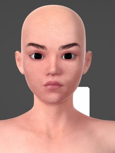

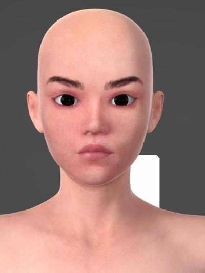

    Oh, and as a followup, here's what the same setup looks like when given a full character texture in both Octane (1st pic) and in Carrara (2nd pic):

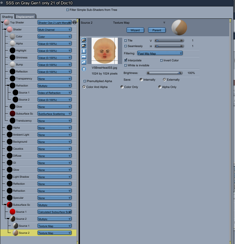

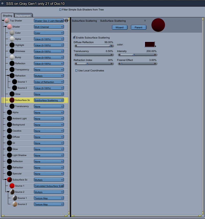

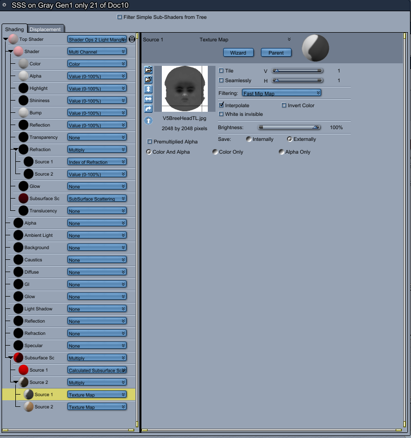

    I didn't have to look too far to find SSS maps; V5 Bree texture has both transparency and SSS maps included, and M5 Philip has transparency maps (though not SSS) so in effect the same V5/M5 maps that come with Carrara already have at least transparency maps.  Also I saw that DimensionTheory has a product in the store called Interjection in the store which has SSS maps for M4, V4, and V5.  Since I was using V5 already I just had a quick play using Light Mangler for the very first time, multiplying the standard SSS times a multiplied combo of both the Transparency and SSS maps for V5 Bree.  All you really need is a Transparency Map, but you can really enhance the effect by multiplying it by a SSS map.
    All I can say is Light Mangler is a MUST HAVE GAME CHANGER when it comes do doing skin SSS, all it took was just a few tests to drive this home.  Without Light Mangler, the SSS shader has to apply equally to the whole character all over, which means either you have too faint an effect on the parts of the character where SSS should show up (like the ears) or too strong an effect on parts of the character where SSS should be nearly as apparent.  But with a transparency map guiding the effect, it's a whole new ball game, and I have full control of making the effect appear only where it should appear, it's terrific!  I am kicking myself that I've never found and used Light Mangler before.
    I kept all my SSS settings the same, except that I kicked the intensity up to 200%, now using Light Mangler and the image maps to guide the effect:
    At first glance it might look similar to my prior render above, and yeah the SSS is too strong really (but that was on purpose to exaggerate the effect and really see what's going on), and the intensity was hiked up a ton, so the ears are 'glowing' much more, but the rest of the figure is not too blown out, meanwhile if you look close you'll see the SSS effect in the nose area too.

    Just a quick note, I'm actually thinking after playing around with it that the greyscale transparency maps are all that's needed, the SSS color maps are just a way in Studio to try to drive/enhance the color, but we already have the color being driving by the original SSS channel, so my original approach of multiplying the greyscale transparency map with the SSS color maps only has the result of diminishing the effect, doesn't really change the colors of the SSS at all.  And I also realized that M5 Phillip has SSS maps included as well as transparency maps, I missed that the first time because the SSS maps included with Philip are also grayscale, unlike many of the early SSS maps we see for M4/V4 characters, which are essentially that the PA just added some blotches of red color over the nose and ears  :)   But the greyscale map approach seems to me the better way to go to more precisely drive the SSS effect.
    Also it's worth noting that DimensionTheory's Interjection products:
    https://www.daz3d.com/interjection-surface-injections-for-daz-studio
    https://www.daz3d.com/interjection-booster-shot-one
    are both on sale today, and include precise SSS greyscale maps for M4, V4, S5, V5, M5, and Hitomi.  I went ahead and picked them up, haven't had any chance yet to try them out, but just at a glance they seem much more precise/detailed than any of the other rough SSS glow maps I've seen for earlier products.

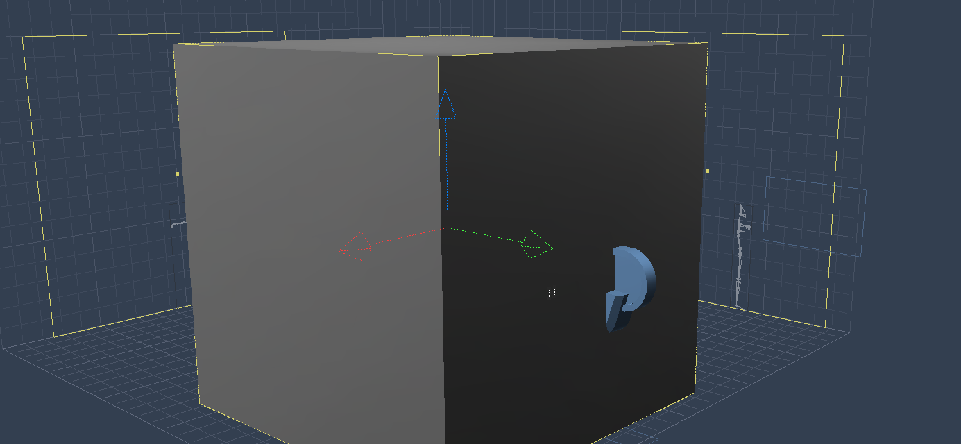

  • My personal findings are that SSS makes your whole character have a glow. To make ears and such glow when backlit, I use a dark red in the translucency channel and no SSS.
    Quick test with the Milenium Elephant with back light, and with light facing forward (same settings).
    640 x 480 - 70K
    640 x 480 - 102K
    That's a brilliantly simple and elegant solution McGuiver.  There's no instructions for using the tranlucency channel anywhere that I could find and I've had problems using it before, but just gave it a whirl and found it seems to accept texture maps ok, so that I can guide where the translucent effect is, however there was still some overspill to other areas.  But it's easy enough to simply select just the ears of my character (for example) create a new shading domain there and put in a texture map multiplied by a dark red color to guide the effect, and it seems to work quite well for backlit 'glow' effect.  I'm stealing that and adding it to my strategy, using it in addition to SSS.
  • McGuiverMcGuiver Posts: 221
    I did some experimenting with the SSS....For me to make it work, and preserve the Diffuse color/texture map I had to keep the Diffuse reflection very low (1%-1.5%)
    Translucency will control the thickness of the SSS....keep this value low to only affect thin parts, such as ears. If this value is too high, thicker body parts will be affected. -- My setting:18.94
    Intensity....With the diffuse reflection very low, I had to crank this all the way up to 500. this may vary with the individual item, but if it is too bright, crank it down a bit.
    Refraction Index...keep this value low (3-10) to get full brightness of the effect....higher values will dim the effect and a value of 0 will slow things down (alot).
    Fresnel Effect Higher values will darken the diffuse color...I left this at 0. If you turn it all the way up, your diffuse color will turn black.
