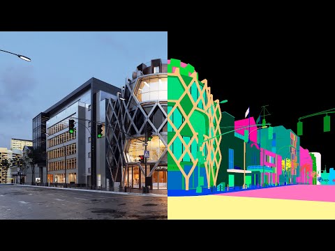

    So I'm happy I came across this product and the solution of the mystery of the Iray canvas Material ID option.  I didn't plan out my current render with this in mind, so I'll need to experiment more with something else, but just yesterday there was an Infinity Photo quickie tutorial that made me want to use the Material IDs very much.  I imagine that other raster editors have similar functionality, so I thought I'd share with others who don't know about this yet.
    I've also attached a sample of the Material ID channel output of my current project.  The output has its own charm, in a Tom Wesselmann kind of way.
    3360 x 2400 - 1M
