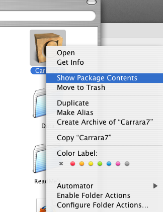

    Actually got it running! I went to an old 8.0 carrara installation and did a show package contents, and copied all of the scenes and presets over to the Carrara 8.5 package contents. All appears to be working now. Just have to remeber to protect all that if I ever delete old installations. Sure my rambling only makes sense if you work on macs and know about the hidden packages contents.

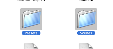

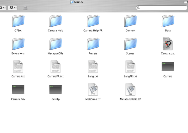

    I would try the installer if you have that option and point it to the C8.5 folder/application.

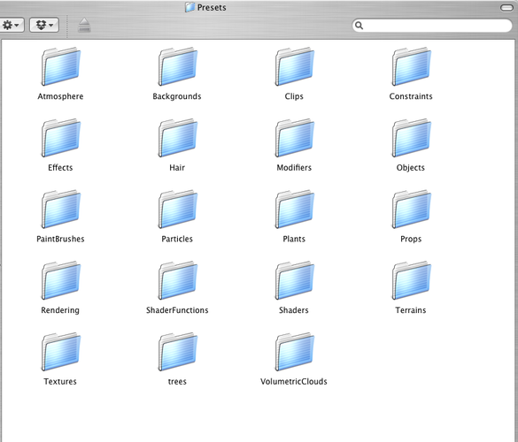

    If you have no option but to do it manually, and you're on a Mac, you may need to navigate to the C8.5 application icon and either right click or control click to bring up the contextual menu. From there, choose, Show Package contents. This will open a new window. Open the Mac OS folder to display its content.
    The two folders you are mainly concerned with are Presets and Scenes. I'm attaching screen shots to give a general idea of what goes where.
    Please note that I'm using C7.2 Pro and NOT C8.5, so the actual contents may differ slightly. I'm also using OS X 10.4.11.
