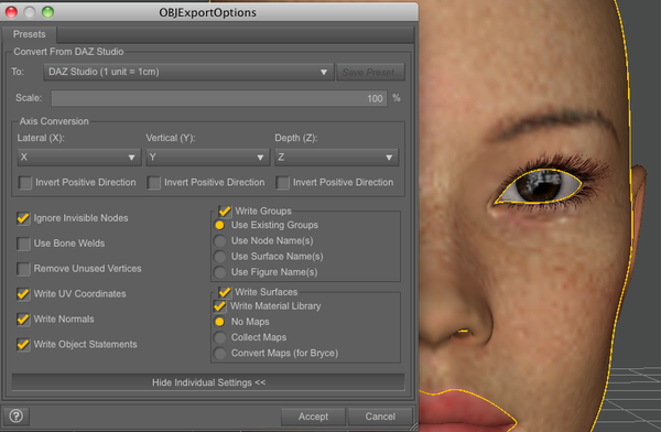

    I tried to export, nothing ever shows up when I import the obj into Morph loader or MLPro on the new figure, it's not shown in hidden either.
    here's the settings Im using for the export, then the import, then the result (no target)

    @Stratdragon : Did you have a pop up message saying the import was successfull?
    @Kikatoredaz : Didn't try to make morph for old figures since a long time. I'll give a try to see what"s coming up and refresh my memory
  • StratDragonStratDragon Posts: 3,291
    yes, it does come back with "Morph Loaded Successfully." at the end.
  • Takeo.KenseiTakeo.Kensei Posts: 1,303
    Seems kitakoredaz is right. I just made the test. Works in DS3 but not in DS4.6 for old figures
    If you have DS3 that's the moment to fire it up. Otherwise I'm afraid you can't do anything but hope that DAZ corrects the bug

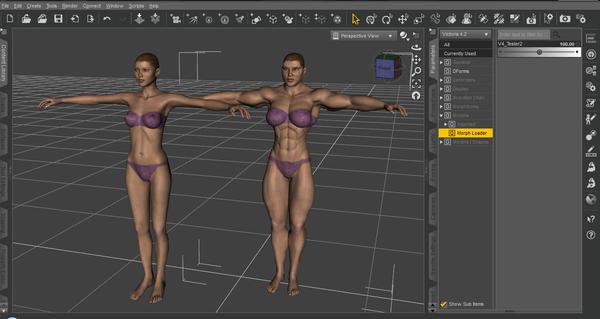

  • BejaymacBejaymac Posts: 2,014
    Figured out why morphloader wasn't working on my OBJ, my export setting was for Tri-Ax figures, which don't need the groups in the OBJ, turns out morphloader hasn't a clue where to put the deltas under "Morphs/Imported" without the groups to help, so it doesn't create the channels.
    Lets see if we can get morphloader working for everybody, now what I've done is loaded V4, injected all of my DAZ morphs, then saved her a scene subset, cleared the scene and loaded in the new DUF I just made. I then started spinning SF4's dials to create Fugly (just don't call her that to her face :P), that's her on the right in the attached pic, I then exported her as OBJ using the default Poser export preset, I then zero'd everything and with V4 selected I clicked on morphloader pro, set the import preset to Poser, set load Morphs for to "All Group/Bone Matches in Figure", clicked Choose Morph file to select the OBJ and once it was loaded hit Accept. What I got in the Parameters tab was pretty much the same as you see under "Morphs/Imported", which is hidden btw, I set the morph to 100% and then saved it as a scene subset to People/Victoria 4/Characters.
    What you see in the Parameters tab in the attached pic is what I got when I cleared the scene, and then loaded in Fugly's DUF, one dial as all of the "deltas" are now hidden under "Imported" just like every other morph.
    The other figure in the image is Dietrying's Sandra character, it uses the PBMCC_27 channel in the Legacy INJection channels, to get this I again loaded my V4 DUF into an empty scene, with her selected I doubled clicked on Sandra's INJ/REM PZ2 file, once loaded I again saved it as a scene subset, unlike Fugly's DUF there was a bit of Asset writing going on during the save.
    All of the files have the empty Legacy INJection channels coded into the DUF, they all have all of V4's morphs available as the morphs were INJected before I made the first scene subset, so they were all turned into DSF asset files. Fugly's morph hasn't been written out as a DSF asset, instead it's coded inside her DUF file, so lose that DUF you lose the morph, Sandra's morph went into an existing but empty channel as a result her morph was saved as DSF assets, however unlike Tri-Ax figures, Poser figures need to have the morph called by the DUF file before it will be loaded, so yet again lose that DUF and you lose the morph, but then this was true of the old .DAZ scene format too.
    Now, as I don't seem to be having the problems with converting to DSON that others are having, could someone tell me what it is you are doing different to me so we can try to figure this out.
