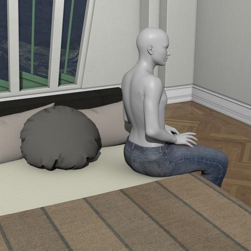

In the render below I'd like to use a D-Former so that the bed is slightly dented where the guy is sitting. Alas, I'm missing something: while I can easily distort the whole bed in psychedelic ways, I'm not managing a small, off-center dent.
Any advice on how to use a D-Former? A link to a relevant thread would be perfectly fine, I didn't find anything via the Search function.

    In DS45+ (I think it was different in earlier versions) you attach the D-former at the root node of an object, so the field starts off affecting all of the object. Not always what you want!
    What I do (this is a personal thing, there are probaly better and mnore correct ways!) is, before adding the node) select the field bone of the Dformer and scale it down, keeping an eye of the level of effect (red/yellow dots) on the object to be affected. I also use the X, Y and Z translations toshift the 'hot point' (the area with densest red points) toward the area I want affected. The area of affect that you are moving around is, in effect, a sphere so as you scale it down you may see it disappear - just shift it on the appropriate axis to bring it back into view. Once in the general location I'll scale it along the individual axes if I want that soet of effect, add points in the pline (if I want a ripple effect) and then, finally, add the node to the object. I then use the various transform parameters on the D-former (the middle bone of the three) to try out the D-fromr to make sure it is doing the sort of thing that I want. If so I take a bit more care over the positioning and scaling of the field.
    Depending on how the bed is made up you might be able to get what you want by giving it a Collision/Smoother against the figure sitting on it - and slowly then lower the seated figure down to see how it goes.

    Ah, it makes sense now! No wonder the whole bed got twisted - scaling down the field size was so obvious I didn't see it :) I'll try that out right away. Thank you very much!
  • GoneGone Posts: 833
    This is modern bed 2 and the problem is with the geometry. The method described would be correct if the geometry was in better shape. Dforms work by moving the verts in the selected area and there aren't enough verts properly placed to get the kind of clean deformation you want.
    Where your man is sitting would require Dforms for the sheet as well as the duvet. Although with the angle you have you could probably hide the sheet and just use the duvet - but if you look at the scene in wireframe, you will see that you will never be able to get a clean deform because of the way it is made.
    The throw looks like it would give a much cleaner deformation but the problem there is that the underside of the throw has the same sort of geometry as the sheet and duvet so won't deform the way you want.
    If you ever manage to get a clean deformation, let me know because the only way I've managed to do it is to replace the sheet/duvet with a high poly cube with a fabric shader on it to take the deformation.

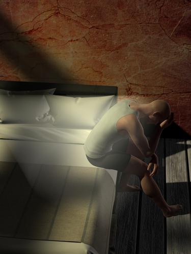

    Yes, I'm afraid the deformation doesn't look that great. I think a hard, non-deformable bed might look more plausible.
    You can see where the render is going...
    Still, another thing learned. :)

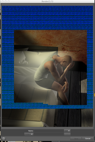

    Here is a quick example where I turned off the sheet and duvet and used a cube with a fabricator shader instead.
    I used a combination of smoothing and a Dformer to get the depression I wanted.

    With my example, I turned off the sheet and duvet objects and replaced them with a resized cube with a fabric shader applied. I then used smoothing and a Dformer to make the depression. The whole thing took about 15 minutes. I expect a less limited solution would take a little longer. ;-)
    Here's a render at a different angle to better show off the depression.
    1200 x 1200 - 259K
