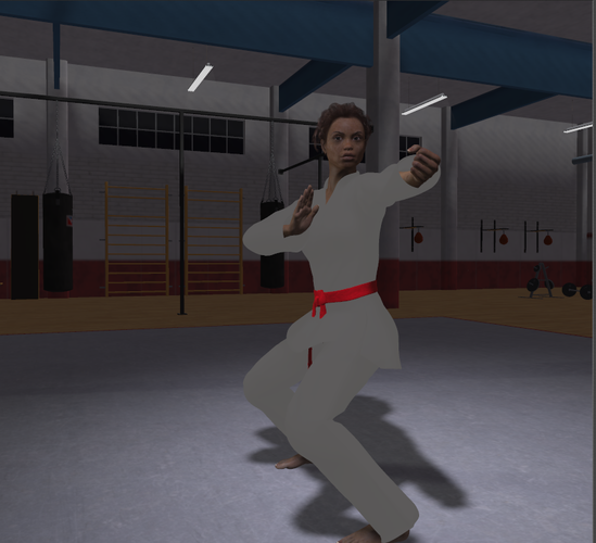

I'm using Poser Pro 2014 with V4 and the Karate Gi sold here on DAZ: http://www.daz3d.com/karate-gi-for-v4
Things look fine in preview, but rendering gives me grey on the karate outfit. I can't figure out why. No issues with anything else.
There's a MAT in poses to select a particular color (different options) and I did apply it with the jacket and then the pants selected.
The product docs don't really give any advice: http://docs.daz3d.com/doku.php/artzone/azproduct/7922
I have a feeling there's something I'm not doing right...any ideas?

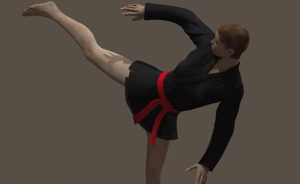

  • WandWWandW Posts: 2,907
    The translucence colour is set to white. Either set the translucence value to Zero (gis are often heavy cotton), or set the translucence colour to the same as the diffuse colour. Attached render is the latter for the jacket...

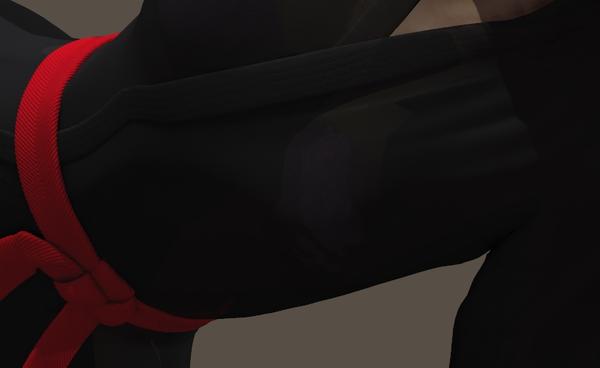

    edited August 2013
    I read up a bit on translucency and as it's implemented in Poser, it depends on the normal direction relative to the light source, so I'm not sure why it is even used in this garment. If you want to give it a light look like a silk gi, dial in a little transparency; here it is at 0.05...

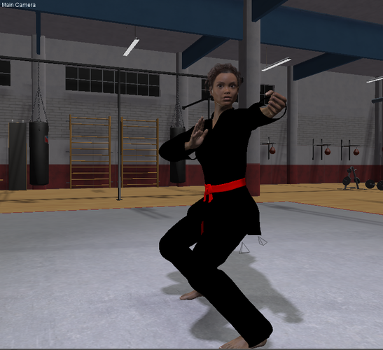

  • raindog308raindog308 Posts: 0
    Thanks so much WandW - that fixed the color problem, though it still looks like a kind of big blob of black color rather than cloth-like. However, when I switch to a white gi, everything looks good, so I think that the bump map doesn't make the folds, etc. distinctive enough if the cloth is black...alternatively, my lighting skills need some honing to show that detail.
