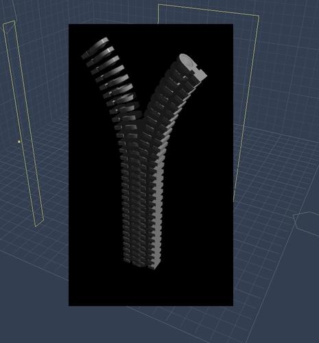

    If you replicate the zipper teeth and then apply the bend modifier, you will end up distorting the teeth. I don't see a way to replicate along a polyline in the VM, but in this example I drew a polyline with segments that matched the height of the teeth; applied the bend modifier at 40 degrees, -90 degrees bend angle, 60% limit, Z axis selected; and then used the ALIGN command to position each tooth along the curve. The trick is to select a single edge along the back of the tooth, Shift+select a single segment along the curved polyline, CTRL+ALT select a vertex along the curved polyline (at the bottom of the selected edge), and CTRL+K for the ALIGN operation. A little tedious, yes, but it does work. The teeth splay out along the curve with out distortion.
    744 x 800 - 108K
