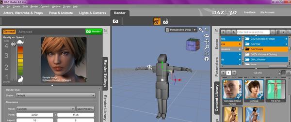

Good night, today I was working so fine with Daz but I got an error. Now, if I want to edit figures like Victoria o Genesis, I got this
Please Help and thanks!

  • drstressdrstress Posts: 0
    Have you moved your work to another computer or reset where DS looks for your "data" or "geometries"? Which character is this? Is it a GenX modification?
  • gabriela230989gabriela230989 Posts: 0
    Nop, I was editing when my character changed. It's Victoria 4, but it also happens with all the characters like Genesis. I didn't change the files or anything. And, what's an GenX modification? Its my 3rd day using this software
  • JaderailJaderail Posts: 0
    Check that you did not Change the Draw Style in the Viewport. Thats the Sphere down arrow set it to Texture Shaded if changed.
  • kitakoredazkitakoredaz Posts: 3,526
    His pic show clear, there is no problem about 3d view port setting
    but when rotate or manipulate figure by manipulate tool, it may happen,
    you may changed setting of "manipulation tool" without intention.
    open tool setting tab, from top menu Windows>pane(tabs)>tool setting (bottom area)
    serch "During manipulation" . (middle of the pane) section.
    then set "Draw style" as "Use current off."
    it can change the shading status when you use the tool.
    edited August 2013
    What figure does it say you have loaded in the scene tab?
    That wouldn't cause those blocks. Those are a geometry issue usually caused when you try to load a figure, say V6, but it can't find the base G2F geometry. It happened to a lot of people when V6 first released, but they didn't have G2F downloaded.
    Post edited by Lissa_xyz on
  • cm152335cm152335 Posts: 421
    could be annoying but, happend to me when accidently i press the key "1"
    check what "Jaderail" propose.
    Umm... really?
    632 x 469 - 141K
    694 x 489 - 74K
    edited August 2013
    Now with that said as the OP is set to Texture shaded I agree the Data is not found. This is probably a path issue in the prefs, or files installed to outdated genesis. The Genesis Starter Essentials has been updated many times and to have all working properly things need to be updated as they come out.
    The Auto Updates in one reason I use DIM now.
    Post edited by Jaderail on

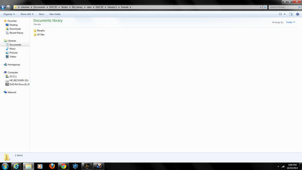

    I am have a problem with the genesis 2 female loading but nothing I see here has worked and it is not a shading or tool setting. it is missing files. after I hit the ok button I get the block figure you see in the picture. not sure what to do have uninstall and reinstall still doing this. and genesis2 female is the only one I am having this problem with.

  • Richard HaseltineRichard Haseltine Posts: 111,965
    It looks as if the geometry files are not installed - or are not isntalled correctly. Do you have a \Data\DAZ 3D\Genesis 2\Female folder, and if so where is it?

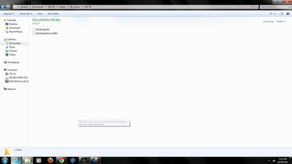

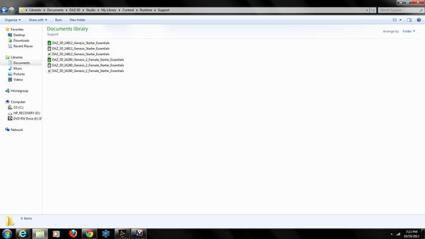

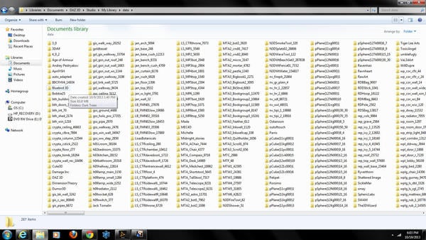

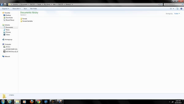

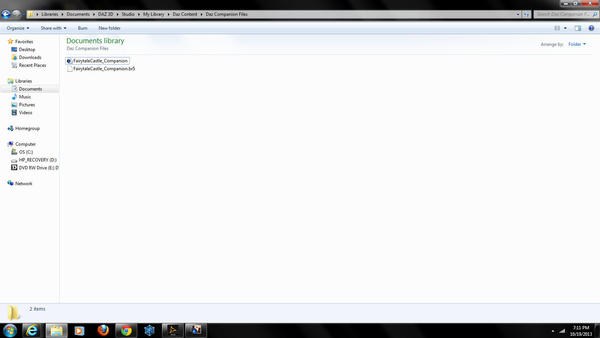

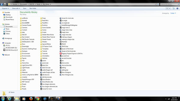

  • Tiger Lee ArtsTiger Lee Arts Posts: 44
    here are my files location and where I found what I think you are asking hope this helps you help me thanks for your time

  • fixmypcmikefixmypcmike Posts: 19,738
    There should be a Genesis2Female.dsf in ...\My Library\data\DAZ 3D\Genesis 2\Female
    I see you have some folders in My Library that may be mislocated: Content, DAZ 3D, DAZ Content. What's inside them? If there are Data and Runtime folders inside one of those subfolders, that's why DS isn't finding them.
    here are whats in those folders
    Looks like you manually installed Genesis Starter Essentials and Genesis 2 Female Starter Essentials -- you don't want that folder named "Content" inside My Library -- everything INSIDE the folder named "Content" needs to be moved up one level and merged with the folders under "My Library".
    thank you that did it now working thanks for all the help sorry again for posting the nudeness was just trying to figure out what was wrong.
