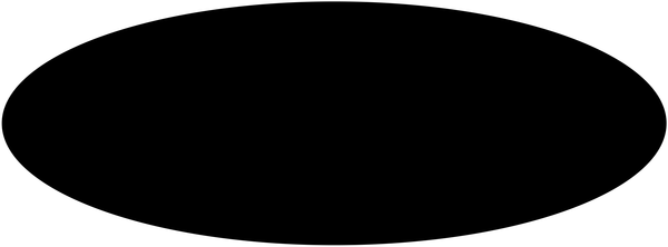

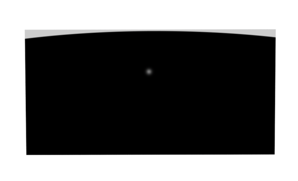

    OK I think I need to start with this issue first. I'm going to keep it simple and basic so that you can understand my problem. The first image is just a sample png texture I placed on the prim. The second image is what it looks like when I actually place it on the prim. It's no point me worrying about the transparency map since I can't get the texture to appear right. That's just a sample to keep things simple, not the actual one I am using, but its the same size as the one I want to use. My understanding is in this case, I would use that original texture also as the transparency map. Any advice on how to get the texture to all appear on that prim as it does in the first image?
    Update: oh and yes to answer your question I am just using a flat primitive, not a sphere.
    All I am trying to do is place that texture (first image) on a flat prim, and block out the white around the oval. I can't get that first texture to appear right on the prim tho :/

    That is odd. What format is your Image file? The Image should auto re-size to match the Primitive.
  • edited December 1969
    Hi there Jade! Yes I thought it was odd too! I was putting the image, which is a png, on a cube and it was overlapping around all the sides of it. I ended up putting it on a plane and that corrected the issue. I wanted it on a cube though because I wanted to give it some depth. Nevertheless, I resolved the original issue I was having, but that lead me to yet another question...is there a way to texture all the sides of a cube differently? I would think there is a simple way to do that, but I dunno LOL.

    Ah.. Primitive Objects have NO UV maps, so it's all ONE big surface. We can fix that with DS4+ now. Use the Polygon Group Editor and Select each face one at a time and SAVE as a new Surface. THEN add textures to YOUR made surfaces.

    Terminological quibble: they are UV mapped, but they don't have multiple Surfaces.

    First question that came to mind was: Is the camera that is being rendered through back far enough to see the entire shape?

    Just needs to be on a plane. Then add Displacement to get some depth to the primitive on the edges would be all I would do.
