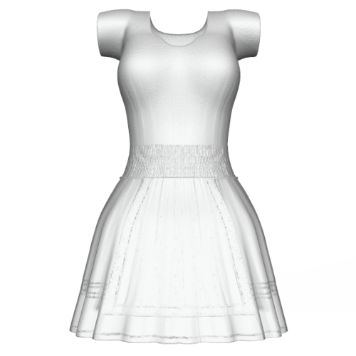

    That sounds backwards to me- gray in DS does not stay "flat, groundlevel" unless the NEGATIVE DISPLACEMENT IS dialed to equal the the positive displacement! that's counter intuitive in my mind. to be a negative number, just to NOT MOVE? makes no sense! ZERO would be null/flat/not moving! Negative anything should be negative displacement.. That's why this doesn't make a bit of sense to me....
    This is a bit difficult for me to demonstrate, as I don't use DS, only Poser. However, this dress is a simple model, with no folds modelled into the blouse part. I wanted to show and embroidered waistline, as in a dirndl skirt. So I simulated it with displacement on the bottom of the blouse.
    I show a close up of part of the displacement map, and then how it looks in poser on the clay model, with noe negative node. As you can see it gives a very soft displacement. As the displcemet map was optimised to work ion DS it would actually give much more defined displacement in DS, but I cannot demonstrate that.
    600 x 600 - 198K
    216 x 216 - 70K
    and a quick render to show how it looks with the texture applied, again in poser.
    629 x 642 - 454K

    I just asked Neil to run a similar thing using the same displacement map in DS 4.6, I think you cann se how much better the displacement shows in DS.
    800 x 800 - 186K
