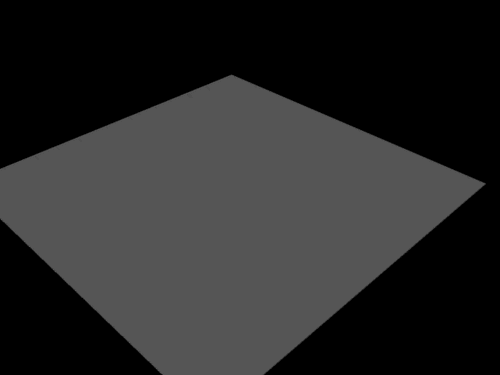

    Got it totally smooth, this GIF doesn't do it justice. Very polished and smooth looking in Carrara when rendered HD.
    I think my colors and highlights were too wonky to make the gif happy so the dither I used adds all those speckles in the GIF.
    Texture map is Isometric camera with colored plane moving across rear wall Alpha enabled with quicktime animation export.
    Thanks for your help.
    8068
