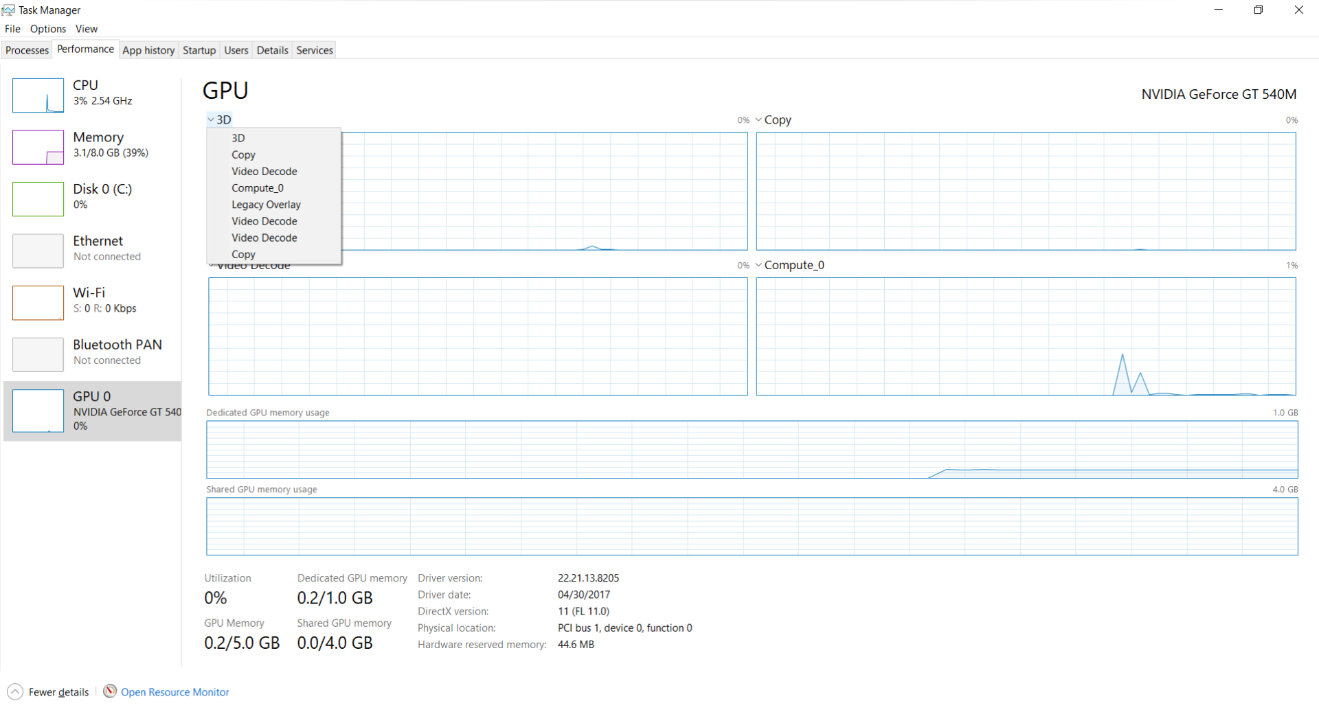

    one question though, when you mentioned the task manager stuff, i noticed it was saying GPU - 3D, i have no idea how to change that!
    Thank you so much for your help!
  • ebergerlyebergerly Posts: 3,255
    To the left of "3D" is a dropdown arrow. Click it, and you can select "compute_0". Task Manager defaults to the "engines" it thinks will be the most interesting and utilized by the average user (gaming, video watching/editing, etc.), but in our case it should default to "compute_0", since apparently that's the GPU engine that CUDA/Iray tends to use, at least on my GeForce GTX cards. That might change with different architectures/generations of GPU's.

    hmm whenever i do that, if i close the task manager it goes back to 3D.
    thank you very much for your help!
  • Where are you seeing this drop-down? I don't have it in the Processes or details tabs of Task Manager, and there's nothing in the right-click menu either.
  • Seven193Seven193 Posts: 1,156
    edited September 2018
    I think it's only for Windows 10, found under Task Manager -> Performance tab, on top of the graphs.

  • barbultbarbult Posts: 27,500
    Here's an example, although I captured this on an old laptop that is GPU-challenged.
    1920 x 1037 - 179K
    Post edited by barbult on
  • Ah, in the graphs. Thanks.
