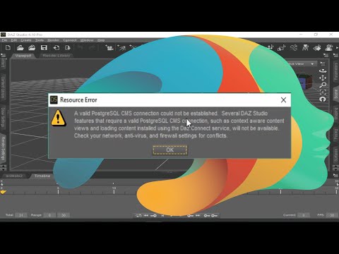

    I bought a new Laptop (Win 11) yesterday and installed Daz Studio 4.22, the the error message showed up.
    I've tried everything, re-install PsdtgreSQL CMS, check the path, re-install Studio, none of theses works.
    The file "dblog" under ContentCluster showed the message:
    FATAL:  role "jc311" does not exist
    ERROR:  relation "customer" does not exist at character 15
    jc311 is my windows user name, is this message helpful?
