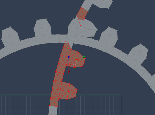

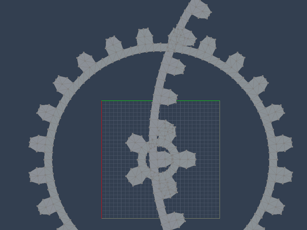

Hello friends, sorry for the dumb question here, in my past I have never been modeling in vertex mode in Carrara, but I found a cool tutorial on YouTube, but I am stuck in a step that I am sure would be an easy one, I have a vertex object that it will be a group of gears, the guy on the video do a selection by one of the vertex part, and after that he selects the entire gear, I can´t do that! If I choose select all, I do select the four gears and that is not what I want, and in addition the gears are overlapped, here a picture of the gears. I wish I am be as clear as I want.

    I need to align each Gear, but I am not selecting each one, here a sample of my trouble:

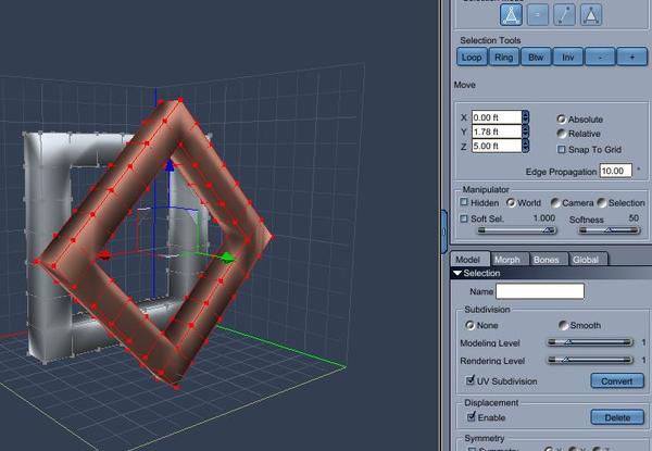

    Not a dumb question. If I understand the issue, I think the answer has to do with two different "select all" concepts. One is using the "select all" choice from the selections menu (or shortcut key) and the other is "double-clicking" a polygon in the vertex modeling room. I think you want the second - which is double-clicking a selected polygon in the vertex modeling room. This will expand the selction to all of the polygons connected, but not those not connected, even if both sets are technically part of the same vertex object.
    In the attached images, I inserted a vertex object. But, in the modeling room I constructed two different cubic gears (and rotated 1). Both are still part of the same vertex object and both would be selected if the menu option "select all" is used. Instead, I selected one polygon on one cubic section. I double-clicked (left click) that selection and Carrara expanded the selected area to include the other polygons connected to that polygon - but not the polygons on the 2nd cubic gear.
    Hope that is the question that you asked and hope this is helpful.
