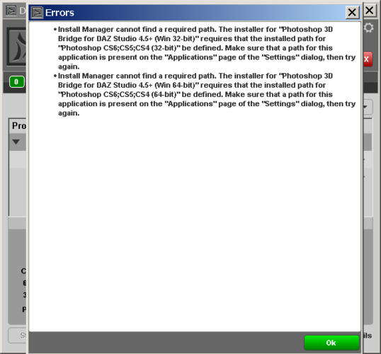

I just 'purchased' DAZ STUDIO' 4.6 online.

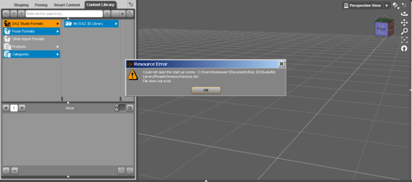

I have encountered two errors as per attached screen shots.

The first error is for installing the Photoshop Bridge for DS4.6. You have to tell DIM where you have PS installed to, if you have it installed. If you don't have a recent version of PS (CS4 or above) the error wont matter. If you do have it, click on the little gear icon in the DIM, and list Photoshop in the Applications tab.
The second error is because the startup file for Genesis has changed format in the latest versions. Go to Edit > Preferences > Startup, and change the file extension from DSF to DUF and it will work, assuming that you have installed Genesis Starter Essentials as well?
JimmyC thanks for your help man.
In regard to the changing the DSF to DUF ext file I had a look in the directory where DIM installed GSE & found the DUF file there so I just changed so the file would load from this location and it seems to be working fine.:-)
