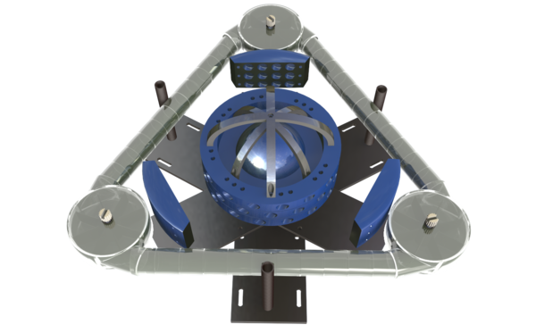

Hello
looking for a little help or guidance.
I have been working on a little project, on and off for a while now, it is only recently that I have managed to get the object files from Bryce into Daz studio.
Now I am wanting to send the object parts to Hexagon to turn into .stl files for 3D printing,
This is where my brain shuts down, as I need to get all the measurements right...... (Spot on/perfect)
Plus I need some parts to be made as solid objects, rather then hollow boxes.
So I would like to know can I turn hollow boxes into solid ones using hexagon and how do I go about making them all the right size.
Plus can I make the whole model as one file with all the multiple objects in place or does each object need to be saved separately.
I have added a picture of what it is I am wanting to build, all parts have been created in Bryce and then sent to daz.
This is only parts of a small desktop toy I am wanting to build, so there is still much to add to it.
