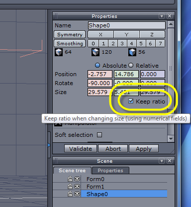

Don't panic! No need to start over. I usually make such items 'small' so everything is on the grid fitting with those floorplans, etc.
Then over on the right tab underneath all those placement and size numbers is a little box to check to "keep ratio". Check that and then resize the entire unit as large as you please.

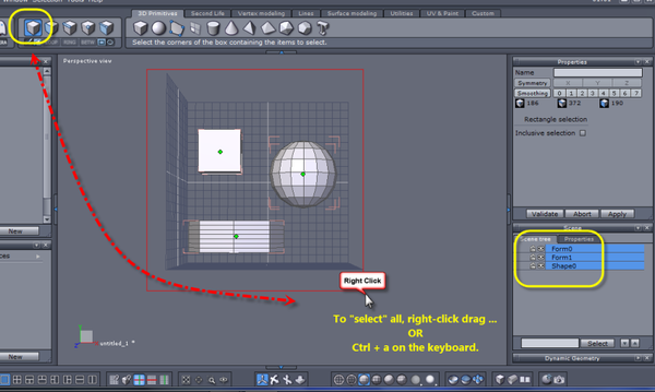

1st. The word 'group' means different things in this program. All the bits and pieces showing on the Scene Tab are "groups". Do NOT weld those all together! [you will lose the uvmapping etc].
To "select" all the groups, in solid mode [I don't know all the terms either, see circle] either Ctrl + a on the keyboard OR right-click drag to select all the items in the scene, check mark in place, and then either by using the yellow resizer cube in the centre of the manipulator OR by changing a number on the properties tab, resize the entire collection as you please.
What size is it to start with ... well the numbers are on the properties tab. If you have the grid showing, and the location of the "collection" of everything is about 0.0.0 you should see it there.

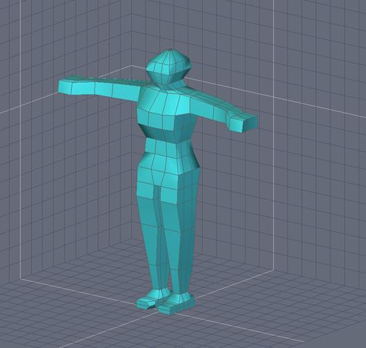

What I did, or do.... is that I made myself a template-file, a lowpoly version of V4.
When ever I'm going to model something in human scale, (poser figure that is) I use this file to start from.
An other thing to be aware of, is what scale-factor are you working on.
I personal prefer to use factor 100. (Others use different.)
That is : if you import a poser figure into Hexagon, with import factor 1, it will come in very small, and hopeless to work with.
So I import with factor 100, and export with 0,01 .
