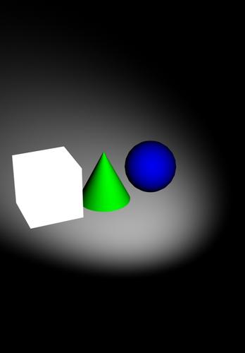

    Here's what I'm trying to do: I've got a square stone chamber, with a burner (linear spotlight) in each corner and a well in the center. I've been trying to apply one of the pw shaders to the water in the well to make it glow. Now I can set the well water's ambient color to white and boost the intensity, but I don't care for the results. Has anyone else had any luck getting the pw shaders to work in DS4P RC3? And if you can, can you tell me how you did it? Thanks...
    *** LATER ***
    What I find the pw shaders to be doing is that, upon application, they inject all the extra channels for their given effects and also change the diffuse/ambient/specular/etc. colors. What one shader will create as pure white, another will create in a shade of green, and still another in a shade of blue. However, I still cannot get them to render their intended effects, either by applying one of their presets or by twiddling with the dials.
    Is anyone having any luck with the pw shaders in DS4P RC3, and if so, can you tell me how you're doing it? Thanks...
    Post edited by Morpheon on
  • ReDaveReDave Posts: 815
    They appear to work normally for me on DS4 RC3, Win32. I have to admit the sheer amount of sliders has always intimidated me, so I only experimented when I first bought them, a few years ago. The presets do render very similar to their respective thumbnails for me (except perhaps Ashen Mountain). If you're twiddling dials try not to overdo the Strengths, try to keep their sums to around 100%, and/or avoid too many lights.
  • MorpheonMorpheon Posts: 738
    edited August 2012

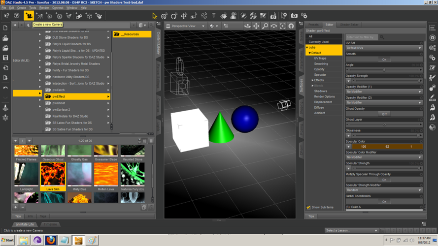

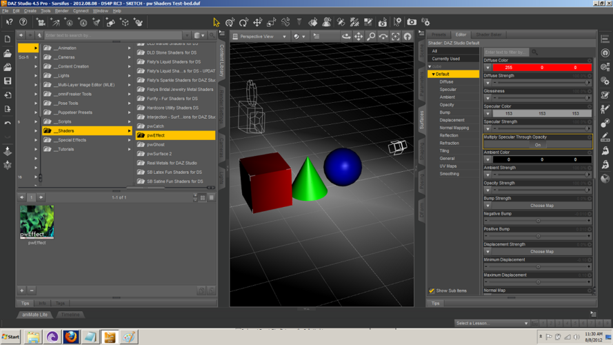

    No, I've been testing them in a very simple setup: just a plane with a cube, a sphere, and a cone primitives, with a single spotlight. When you apply a preset, should it be apparent in the preview window, or is it only noticeable after rendering? For example, on my machine, selecting the cube and then clicking on the pwEffect shader will add all of the other channels to the cube's properties list in the Surfaces tab, but doesn't visibly change the appearance of the cube.
    In the second image, I've selected the "lava skin" preset, and you can see that the cube has turned to pure white (you can also see that the specular color has changed to a brownish color more appropriate to lava), but it will render out as pure white, not as a lava cube.
    BTW: I know about holding down the CTRL key (in Windows) when using Omnifreaker's tools, and then selecting between "Replace" or "Ignore", and this would seem to be similar, but neither option makes any difference with the pw shaders. The extra channels all seem to start out set to "None" or "No Modifiers", which I thought was part of the problem, but even manually setting them makes no difference.
    The only other difference I can see is that I'm running the 64-bit version of DS4P RC3, and you're using the 32-bit.

    Sarsifus said:
    When you apply a preset, is it apparent in the preview window, or is it only noticeable after rendering? . . . I've selected the "lava skin" preset, and you can see that the cube has turned to pure white (you can also see that the specular color has changed to a brownish color more appropriate to lava), and it will render out as pure white, not as a lava cube.
    From what I recall (it's been a while since I've used these), the effects only show in the completed renders, not in the preview window. Render your lava-skin test and see what that gets you.

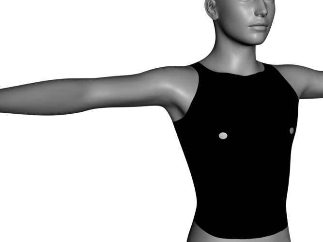

    Oh good point, Ambient in pwEffect acts as minimum colour of a surface, which is different from what DS uses (DS is the odd one out in that regard). You really have to dial it back a lot if you are used to the DAZ default material.
    I tried applying the shader to Genesis' torso, without applying any preset, and setting the Diffuse, Ambient and Specular colours to black yielded what looks to me like a black torso.
    900 x 675 - 142K
    So in your render, does that count as a success or a failure of pwEffect?
