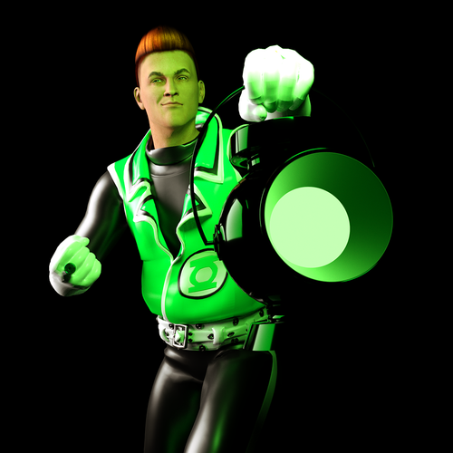

    A background does help in bouncing/reflecting light towards the subject and I use that a lot :)
    Sometimes I do want a black background like this render with Guy Gardner (still a wip because so far it's 1.1k s/p :P )
    imo you'll have better luck with mesh lights, which is my default light (and suggested by Paolo, Reality's creator). In the scene with Guy I had 1 mesh light off at an angle, converted the interior of the Power Battery to light and scaled the intensity way down, then put a mesh light above the Power Battery, reduced it to 25%, intensity of the light was reduced as well).

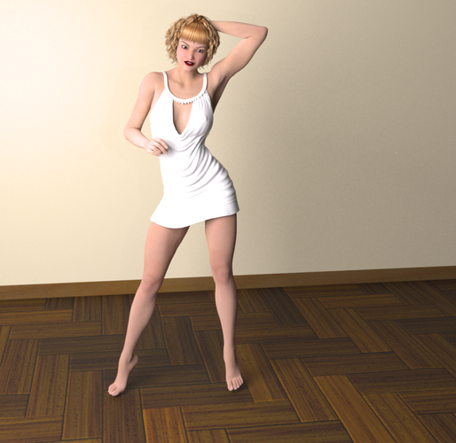

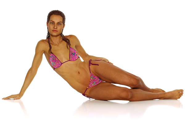

    You can also use mesh lights both as a background and key light for a high key look like this shot of Gia :cheese:

    Heres a render with 1 mesh and 1 spot light. Looks good still no where near to those great ones
    It's not bad for an early effort :) What are your settings for the skin and hair, specifically the glossiness strength?
    I thought uber environment didnt work with lux renders so i never used that.. I will give it a try and post the result here
    Both Luxus and Reality will completely ignore the UberEnvironment lighting you add to a scene. It simply cannot convert it to Luxrender because they're very different types of light. The UberEnvironment light is actually a 3Delight shader and cannot be used outside of that render engine. Unfortunately, while Luxus will allow you to approximate this with it's many lighting options, Reality 2.5 is very limited in this regard and doesn't support any of the light types which give a similar effect.
    At any rate, I'd argue the lighting isn't the problem in your last render, but rather the materials you've used. The material settings for items in your scene will HUGELY impact the final output. It changes how the light behaves when it interacts with a surface, how the light is reflected and therefore how the reflected light then responds to new surfaces and so on. This domino effect means that poor material choices can cascade into ugly lighting and vice versa.
    Reality has an ACSEL shader download built in, but I've personally found it next to useless so I prefer to set up my own material options and use them as presets. While I haven't used Reality much since getting Luxus, I can recommend some choices. First, use glossy for skin, nails and hair. Since there's no glossy translucent, you'll have to make do with second-best. Keep the gloss over 8k, but no higher than 9k, except perhaps for the nails if you want them to be more reflective (good for nail varnish). For the floor, again use glossy with a reasonably high value. If you put this value to maximum or close you can actually get reflections in the floor, which make it seem very polished.
    The rest comes largely from experimentation and experience. Picking the right type of material for the surface is vital for making good renders, so play around to see what works for you.

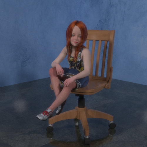

    For render in my previous post i had mainly used all matte material with default values.
    Heres new render with skin and stuff glossiness value to 8k.
    I have to reduce spot light otherwise it seems to bright.
    1837 x 984 - 227K

    Even with matte textures you can get decent results.
    Try experimenting with the different Film Response settings. Under any given lighting the different film responses can make a huge difference. Fortunately you can experiment live in the LuxRender GUI. Try changing light colors and levels with the film resonses. The differences can be quite dramatic.

    As a point of note, I'd avoid using Daz spotlights in Luxrender. If you need a 'spotlight', then create an actual spotlight by using meshlights. The softbox + snoot combo is designed for this sort of work and gives a good spotlight if you scale it down and extend the snoot.
    The problem with spotlights is that they don't really 'work' in the real world. Spotlights in 3D programs like Daz start at a point and cone outwards, but in the real world light disperses in ALL directions from the light source. The reason real spotlights work is because they use plates to funnel the light to a specific area. The closest you can get using pure lighting in Luxrender would be by using an IES file to simulate the light path.
    Other than that, it's really a case of playing with the material settings to find a good balance. I personally disagree with Vanguard's opinion that you can get good results using pure matte, and feel you should always use the appropriate material for the surface where possible. In lieu of cloth material for clothing, again I recommend the use of glossy, glasses and metals should also be used where appropriate.
    The film response is really exactly what it says. It won't affect the lighting directly, nor will it change how the materials react but it will change how that information is translated to the camera. You can emulate older cameras or the latest high-tech movie cameras by changing the type of 'film' being used. It comes with multiple presets to choose from, and can add interesting accents to an image.

    Edit #2: Here's a quick example I put together which was rendered using Reality. I used two 'spotlights' as the only illumination in the scene, both of which used the softbox and snoot combination to emulate a real world spotlight.
