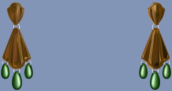

The first of the attached images (Or at least, the one numbered _1; Preview alone doesn't tell me the order they'll appear when I click Post) is of the earrings from the Harmony package. (which is at http://www.runtimedna.com/Harmony-for-Aiko3.html if you want to see) Currently, the model uses three materials; one for the shells, one for the rings, and one for the teardrops. The mesh is articulated, by which I mean that the teardrops and shells can be rotated independently of each other. (I'm not sure if "articulation" is the right term for that; the second image should hopefully indicate what I mean if it isn't)
I'd like to change the mesh to allow the teardrops to be assigned different materials. (Or at the very least, separate them into three pairs) That part, I've managed to figure out on my own; I've managed to learn how to edit the mesh in Hexagon to achieve this, by selecting the relevant faces and assigning them to a custom shading domain. What I haven't figured out how to do is how to do this without losing the ability to use Fit To or losing the articulation.

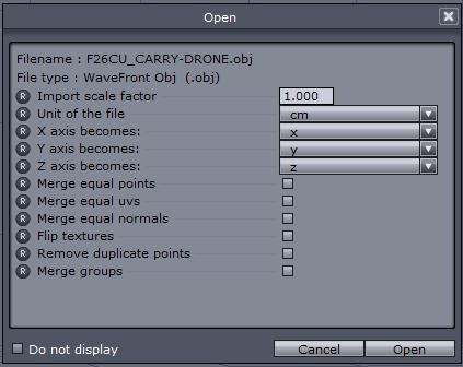

2) Exporting the file from Daz Studio as an OBJ (which seems to be the only format common to both programs - they're both Daz products and yet there's only format in common between them? The hell?) and then importing it into Hexagon. Even when I set both to the same units - I use 1unit=1cm in the Daz Export window with a Scale of 100%, and in the Hexagon Import window I set the scale to 1.0 and units to cm - the scale is off by an order of magnitude. And again, two of the rings wind up with the wrong material.

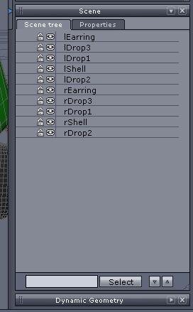

3) Opening the file in Daz Studio, then using Send to Hexagon; using this method exports everything as a single object - where the shells were separate objects, and each teardrop was also a separate object, now there's just a single entry in the Scene palette. Which means that if I save to a new OBJ and then try to re-import it to Daz via an edited CR2 that points to the modified file, it fails to import the geometry, because the object definitions that the CR2 expects to be there don't exist. I have, as yet, found absolutely no way to recreate the original groups.
Attached image number 3 shows how the Scene palette should look for the CR2 to work properly; Image number 4 shows how it looks when I use Send to Hexagon. (Aiko 3 was in the scene to give me a point of comparison while I was trying to figure out the right scale setting for importing the OBJ - this was before I noticed the material problem)

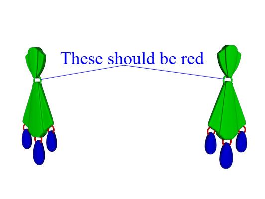

The attached image should illustrate this problem. Any suggestions?
Let me reiterate; all I've done here is to load the original, unedited OBJ into Hexagon, export it with the same settings with a new filename, and then load it into Daz Studio from a CR2 modified to point to the new filename rather than the old. I edited the Diffuse colour in Daz Studio before I rendered, to show the different materials. (Shell has a Diffuse of #00FF00, Rings is #FF0000 and Teardrops is #0000FF) The mesh hasn't been modified in any way in Hexagon.
