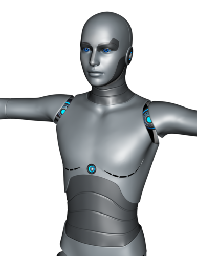

    I'm not sure but I just did a quick test render and it seems to come out fine for me.
    The steps I used were:
    1. Load Genesis and dial in a bit of female shape.
    2. Apply the wearable to Genesis (Botgen_All)
    3. Load a preset light set - I used Daz Dimension Lights # 12.
    4. Render
    This is what I get. As reflective as it is I can see that if you had a strong white light in your scene it could come out all white.
    When I loaded the wearable it was mostly all grey but you could see the blue wiring bits.
    1000 x 1300 - 2M

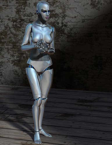

    Hmm...Not sure what's causing it but that's not what I'm seeing. Is it possible some of the materials got corrupted?
    Here is what I get after loading Genesis, applying the wearable then applying the various materials. The first is the Quick Mat and the second is the Base Mat.
    1000 x 1300 - 718K
    1000 x 1300 - 624K
