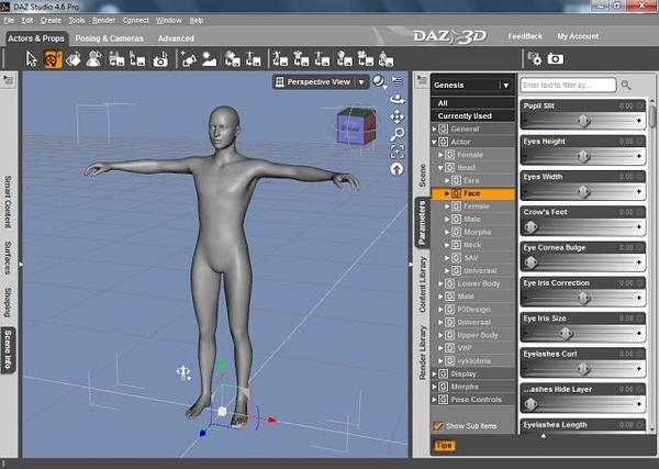

That doesn't appear to be correct. However, I'm using DS4.6, maybe that could cause the difference here.
But if you look at my screenshots you'll see that if I have the main actor ('Genesis') selected I can still access the controls for the head, face, etc. Only it's not located in the pose control area but lists under the actor tab *.

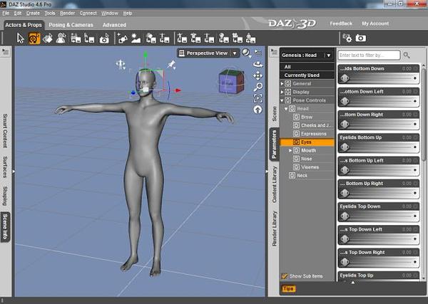

If I then select something specific, like the head in my example, I now need to head over to the pose control areas where I can find these options.

You seem to have the same situation as I do. What you've shown on your second picture is _Actor_ node, which is for morphs and yes, head/feet/eyes and such _morphs_ are located under Actor.
But I'm speaking about _Pose Controls_, which is for pose dials and you seem to have the same situation where pose controls for head located in Genesis: Head node, as it is clearly seen with your first picture, so you need to select Genesis' Head to get access to those pose controls.
In G2F all pose controls for bodyparts (such as head/feet/hands) are located in main Pose Control node, so you don't need to do extra clicks to select G2F head to be able to use G2F head pose controls. I want to do the same for Genesis.
When you select Actor/UpperBody/Hands, for example, do you have access for Left Hand Fist pose control so you can curl left hand into a fist? Because I don't and my Left Hand Fist is located in Pose Controls but only if I select left hand bodypart of Genesis.
