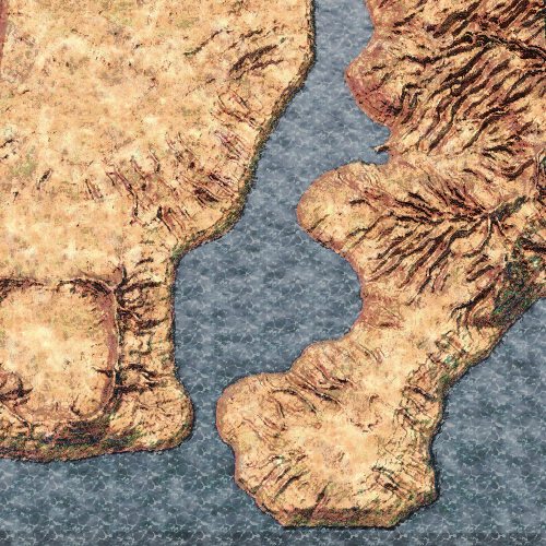

  • FirstBastionFirstBastion Posts: 8,085

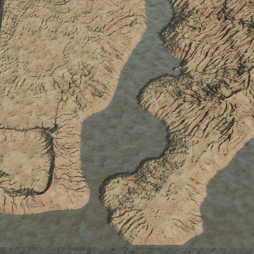

    You might be able to get something like this, but it would be a challenge to duplicate an existing map, though as David mention starting with a greyscale or black and white image of the coastal outline could get you started. But if your finished image is going to look like a map, then reserv's Cartographer option looks like a smart choice.

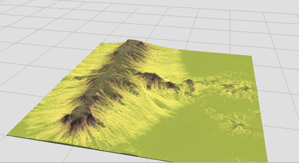

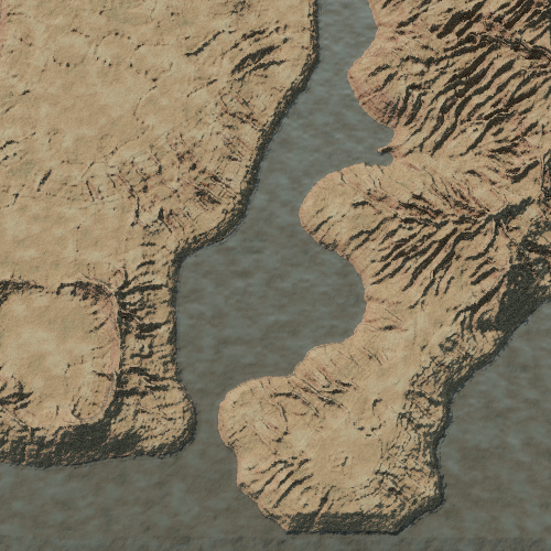

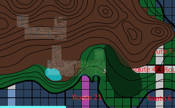

    Here's (the attachment) one of the parts of the map where I am having the most problems.

    Hmn. This all sounds very involved. Maybe if you gave us an example of how you wanted your finished map to look (since there are so many way in which this kind of information could be conveyed) we might be in a better position to suggest how you might go about creating the effect you are looking for. For example, I like this style of map, but it would be hard to achieve this effect using Bryce alone.

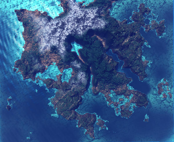

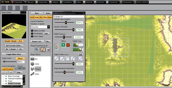

    Painting grayscale heightmaps can be a pain since you need lots of tests .You will have to see ,test, save your work often even for every tiny line added .Also a height map tiff image carries additional information , only in tiff you must work, never convert into jpg or bmp.

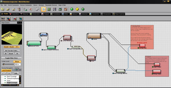

    Have you considered to use world machine 2 ? There is a free version (basic) fully-featured but with maximum terrain resolution up to 512x512 and non commercial.I'm not sure if the offer is still available, check their website http://www.world-machine.com/ on http://www.world-machine.com/download.php . Can run on 32bit XP too. If you decide to buy it , the standard edition (100 usd) is enough for an amateur/hobbist artist.
    world machine and terragen are both node-based applications but the WM is way more simple and easy to use and very fast worlds builder compared with the terragen rendering time (terragen can use terrain shaders or even create ambients).When you'll get experience in WM you can achieve great results very close to terragen terrains.Unfortunately there are NOT many tutorials for WM, you'll have to dig WM forums for hints/tips and to play a lot with this app.And it is also stable, the only rare crashes i know are from low RAM on the computer (2-3 gb ram) when working/building with a very high resolution, 2048 or higher.
    Another method to create terrains would be with vector displacement maps + a modelling/sculpting program and using stamps on a plane to be imprinted and save as height maps 16bit .tiff and then import height map into world machine (or directly into bryce) to make erosions if needed but it takes time and lots of tests in bryce . http://www.sharecg.com/v/67171/view/5/3D-Model/Klendathu-for-Bryce have mountain created with vector displacement maps (stamps).
    If you decide to use world machine post a reply here and i can send you this project in 512 with mountain layers to play with it.Don't worry the yellow fine erosion channels at the base of the mountains wont appear in Bryce.
    Also see the http://www.sharecg.com/v/70849/view/5/3D-Model/Craters-Construction-Kit a height maps pack mostly with craters but you'll find base terrains with low mountains.Already downloaded by someone to be used in Sim3 mods.
    Another method is, as Jamahoney suggested me, is to use DEM files but i'm not familiar with (i don't know) this kind of workflow type.
    Don't take my post as an advertisement , i'm not payed for this ,it's up to you what you decide to use.

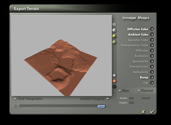

    I notice bryce tends to crash when trying to export a mesh with over 100 thousand triangles. Is this from my computer, or the program? IE: if somebody with a better computer tried to export it for me, would they have less of a chance of crashing?
    If so, I may upload my bryce file somewhere so somebody could try exporting it at say, 500 thousand to 1 million triangles? Alternatively, is there a way for bryce to selectively lower the triangle count in areas that require less detail?

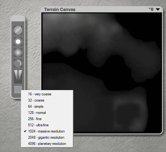

    Also Is there a way for the resolution of the terrian/heightmap to equal the resolution of the input heightmap, instead of 512/1024 and so on?
    Lastly, is there a smudge or blend tool when painting the heightmap?
    Yes, there is that grid thingy, click on it. You can go as high as 4096 x 4096. Though you cannot set the resolution other than what's offered in the drop-down.
    The terrain editor has a great many of options, which you should experiment with. You can select parts of the terrain and change the selected part without changing the other parts. You have sharpening and smoothing filters.
    Though the preview is square, the terrain needn't be square. You can load a height map in any aspect ratio - though it will be displayed square - and set your terrain to the same aspect ratio and you're set.

    Exporting a mesh - with the terrain selected, go into the Terrain Editor by clicking on [E].. On top right of the terrain canvas is a down arrow. Click on it, then click on Export.

    OK I know it is a bit tedious going through all the tutorials, so I'll just cut to the chase here.
    1 - to export at that level of polys drop the resolution to Massive - that will free off a bit of headroom for the conversion.
    2 - use the export option from the dropdown.
    3 - do remember to turn off all the Image Maps - don't export the images directly - that's a really bad idea. Instead follow the process outlined in the tutorials. Yes it is more long winded, but the results will be better. Maximum resolution looks to be about 2 million polys. That creates an output object of 215 MB! So 10 million... well that would be a pretty big object. And probably include a lot of redundant information.

    That's odd, I was able to get it to 6 million without a crash, but it's still not enough detail for what I need. I'm sculpting it in mudbox after the export, and for the level of detail I want, I need more than 6 million
