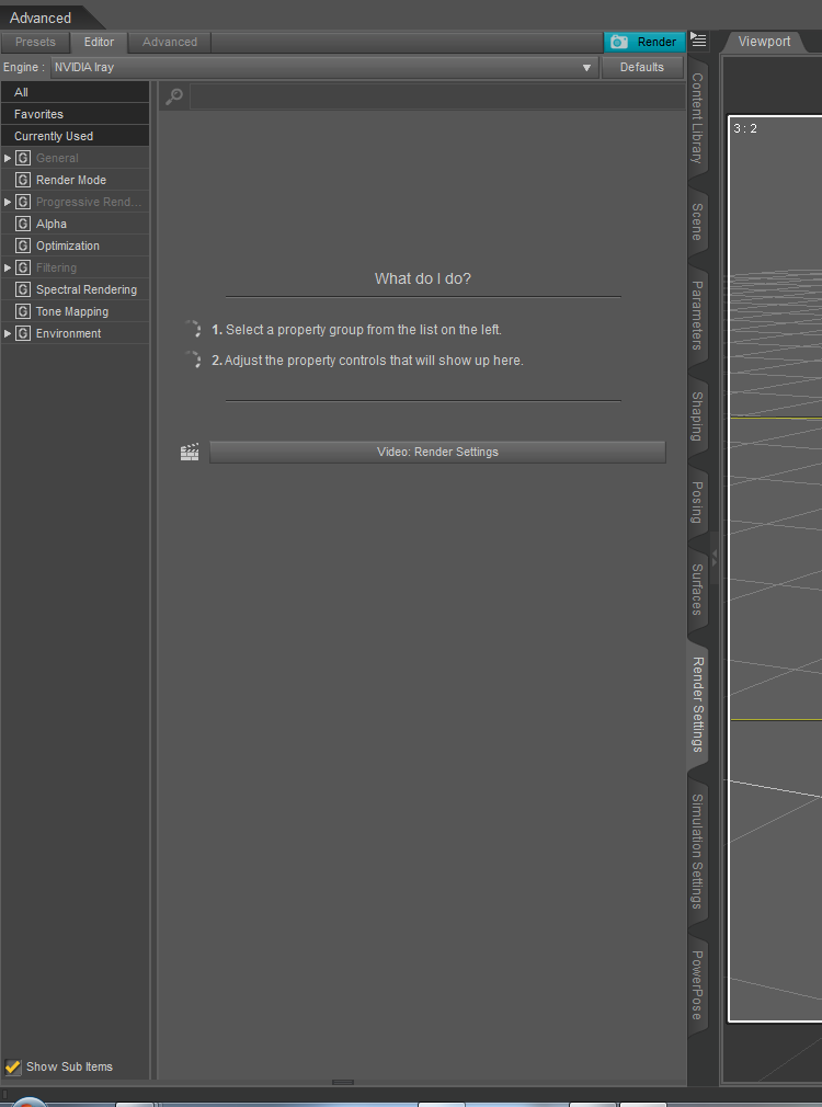

  • fastbike1fastbike1 Posts: 4,085
    edited August 2018
    @Richard Haseltine "I'm not aware of a way to get Activity Tabs (Posing | Shaping and so on) vertical."
    Does this mean my layout isn't possible???? I perhaps did not understand your comment.

  • FSMCDesignsFSMCDesigns Posts: 12,858
    He/I meant the pane tabs and your look is what I was going for and he gave me the answer.
    Sorry, that was a bad example - I meant the tabs that give different layouts, one of which is labelled "Posing | Shaping", not the Posing and Shaping and other tabs.
    NorthOf45 said:
    As for moving tabs around and having more panes, first understand the difference between them. A pane holds one or more tabs. A tab cannot exist without a pane. You can move tabs around to different panes by click-dragging the area with the tab itself (where the tab name is) onto another pane or somewhere else in the order of the tabs on tha pane. If you drag it off the pane, it will create a floating pane with the tab you dragged.
     Pane is the official name for tab - hence Panes(Tabs) as a sub-menu of Window. Pane Group is what you mean when you write pane here.
