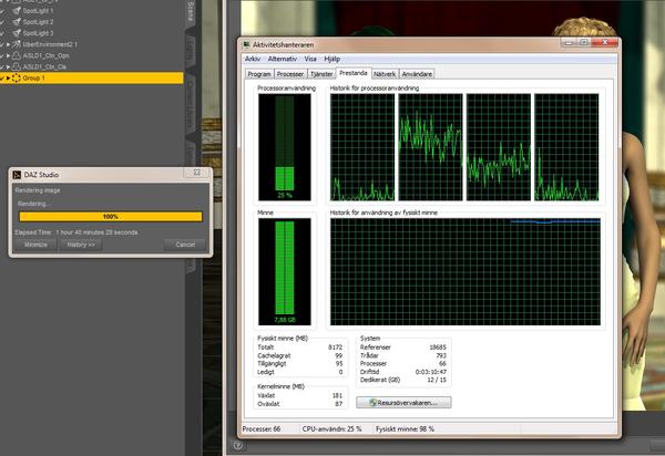

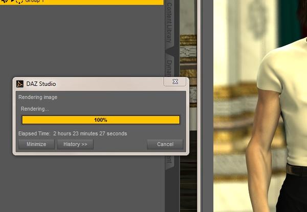

I rendered a picture that took a bit over an hour to render (quite a lot of shaders in it, hair and details). However when it came to 100% I had expected that I should be able to type the name of the picture and than go and do the postwork I planned.. however, it has been on 100% for the last damn 25 minutes now !?
I took a screen shot which also shows my.. uhm.. not sure what it's called in english again, but either way.. and apparently it seems that despite that the render is finished (100%) it still using up almost all of my 8gb RAM for some work in the background? On top of that, I checked to be sure there wasn't anything else working, but the Only thing that is active is Daz Studio and the render... so well, what exactly is going on?
I might add that this is the first time since I started with Daz that something like this happens
And as I have to go to the store, I hope that it has resolved itself by the time I get home.. if not I honestly have no idea what to do :/ Don't want to lose the render I did as I am honestly afraid it would just end up doing the same thing if I re-render the picture.
Edite - Back from the store.. and it's still going on despite being 100%... it's been on 100% for around an hour. *sad*
