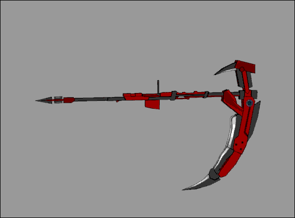

I watched RWBY recently and was surprised to learn that it's done with poser 2014. The transformation of cresent rose (heroine's weapon) seems very complicated. According to the analysis of some fans it's a linkage (and slider) system. It's easy to realize in engineering software like CATIA. But the newest poser version I've touched is 8 and I saw nothing like adding constraints in the movement simulation. Morph is simple interpolation according to my understanding and is also not possible to support such movement. Does the newest version have revolutionary improvement?

    The attached pic is a mechanism I saw.
    580 x 429 - 317K

    That looks like the sort of thing that can be done with ERC linking rotation on various body parts to a single control property, with different constants subtracted (or added) to keep the value 0 until needed (Figure>Use Limits does need to be on, or the uselimits values in the CR2 set to 4 to override the setting). Valandar did something similar with a transforming robot, as I recall, and there have been other, usually more limited, examples over the years. Edit to add: the spear head at the front probably is a morph, but the principle is the same.
