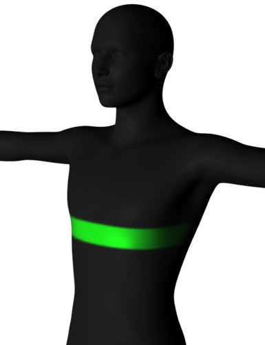

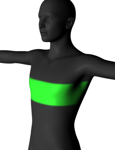

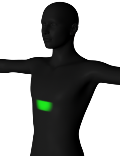

  • JaderailJaderail Posts: 0
    Hmm... a Single Plain with a Trans map and the Spread angle of the light set to Wide. Then as you move the Plane closer to the light the beam should widen and then tighten as it is pulled away from the light again.
    Tested this for you this is what I got.
    500 x 650 - 153K
    500 x 650 - 148K
    500 x 650 - 147K
  • Sentinel-3Sentinel-3 Posts: 52
    That's another way, I actually didn't have a chance to think about that. Though by widen, I meant widen from a point to a line. Thickening the beam was easy by separating the planes.

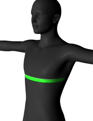

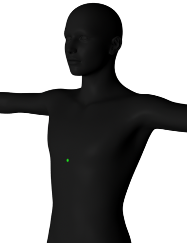

    edited August 2013
    Point to beam? Easy, use a Spot light and the width setting animated with the plane. The thickness of your Transmap opening will dictate the height of the beam of course.
    EDIT: I suggested this so you have less overhead. The fewer objects loaded the more RAM you have free to render.
    500 x 650 - 140K
    500 x 650 - 138K
    500 x 650 - 137K
