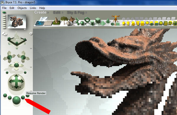

If you have a long running render, it often is handy to interrupt it and save the actual progress and even close "Bryce". E.g. if you have a notebook and should go to work with it, but there still is a render on-going. (That is the situation I have a lot.)
Bryce can do that. Actually it is rather easy, but I needed nearly one year to realize how it works. Now I would not miss that function anymore. Because it is not that obvious, I thought I write a short description how to do that...
First you begin to render your scene while you either click on the "Render" button, or choose the function "Render" in the "File" menu or press the keys CTRL + R.
To interrupt the rendering you click on the "Resume Render" Button right next to the "Render" button or you hit once the Escape key. And know you can save your scene. It saves the actual state of your render, too. Afterwards you can close Bryce and shut down your computer.
If you like to resume your saved render, you have to do the following.
1. Open your scene. You will see the rendered scene exactly the way, how you leave it.
2. Now you click on the "Resume Render" button. (Here it is essential not to click the big "Render" button, because this would start the render from scratch and maybe 20 hours of rendering are squibbed.)
3. The render resumes.
A last remark if you are using the Escape key to stop the rendering process. If you accidentally hit it twice, the wire frame presentation appears. That's no problem, your render progress is not lost, then the Escape key simpley toggles between the to presentation: wire frame and rendering.
