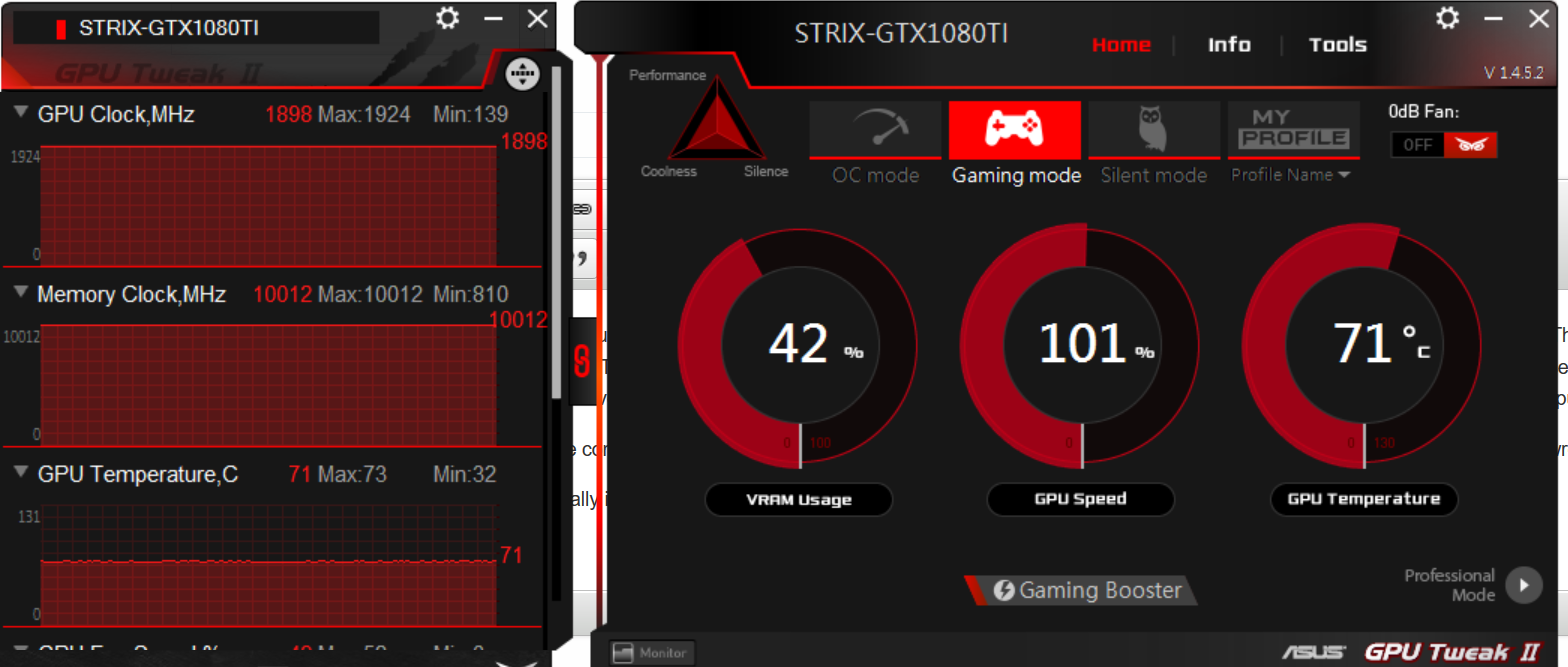

Is this normal for a 1080ti?
WonderlandWonderland Posts: 7,137
edited August 2018 in The Commons
I know there are a lot of reflections and stuff but this has been rendering 1 hour and 20 minutes and still is at 0% 1964 iterations. The full size is 2400x2000 (This is as much as I could get in a screenshot.) This seems about as slow as my CPU only Mac & low end laptop... There is no added subdivision or smoothing on this one. I did bump up render quality and max samples because otherwise it tends to end early and non-converged even at 99.8 convergence.Is it because of the shiny reflective surfaces or is something else weird going on? Does a screensaver slow/stop the render? Why does my computer fall asleep while it is supposedly rendering?
I have some sort of app that came with trhe computer to put it in game mode which I did, thinking it would speed it up, but clearly it doesnt. What am I doing wrong????
This may look more converged than it actually is because I have to reduce the size for the forum.

  • Dim ReaperDim Reaper Posts: 687
    edited August 2018
    Looking at the GPU clock speed on the screenshot, and the temperature, I would say that it's comparable to my 1080ti so I would surmise that it is indeed rendering correctly.  If it had fallen back to CPU then I doubt that you would have a temperature of 71 Celsius.
    I think that the problem is more likely to be that as all of us upgrade our machines, we then start creating higher resolution and more complex images.  Once you've completed this render, try setting the render settings to default and give that a try - the 1080ti should be a lot faster.  After that it's a matter of tweaking the render settings for a particular render.  It might also be worth loading up a scene that you did previously before you have the 1080ti and rendering that just to check that it is as fast as it should be.
    It might also be worth posting your render settings once you can access them - there are plenty of people here who could give advice on how to optimise them.

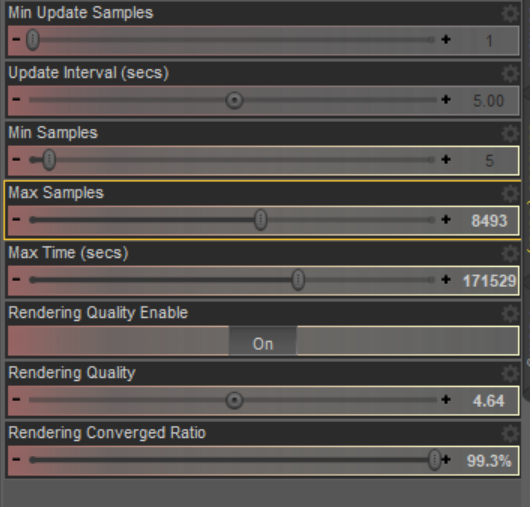

    I stopped the render for a minute because it's still at 0% after 1 hour and 50 minutes!
    On my CPU computer, I would put it at 99.8 or so converged and max out the time and eventually it was done, but when I put it at 99.8 (ish) on the 1080ti, it renders fast but is not converged at all, still really grainy! So I bumped up the render quality and max samples to random numbers. I have no idea what the real numbers should be and others said, doing that increases render time, but if I don't, it ends early and I just get a lot of grain! One time I put it at 100% converged which is supposed to go on forever until you stop it, but it stopped anyway, still not converged. The only way I can get it to converge is with these larger max samples and render quality. But I'm just randomly bumbing them up, I have no idea what numbers they should be at.

  • Render Quality of 4.64 is very high - as I understand it there's a roughly linear relationship between render Quality and time, so you are slowing your render by a factor of 4.64. Do you really need it that high? I can imagine the default 1 might be too low, as it might leave a lot of unresolved noise in the areas that hadn't converged once the rest of the image had reached the covnergence point, but I'd try smaller increments to find a value that worked (or do spot renders to fix up the noisy areas, or in the beta use the de-noiser).
  • zombietaggerungzombietaggerung Posts: 3,969
    edited August 2018
    If you turn off Render Quality and put the Max Time to 0, the only thing that will determine how long it renders is the Max Samples setting. Then you can put that up to something like 15k samples and it should render pretty clear. Even with alot of reflections and shiny surfaces.
    Post edited by zombietaggerung on
    Wait, what? What is the de-noiser and where can I find it??? Thanks.
  • AllenArtAllenArt Posts: 7,176
    edited August 2018
    The denoiser is only in the new beta for now. But I agree that 4.64 for the rendering quality is VERY high. I never go over 2.00 to be honest.

  • deathbycanondeathbycanon Posts: 1,227
    I have been doing what Zoombietaggerung says, but I push max samples as high as it will go and then just stop when I like the look of the image. I had one that would NOT render clear - I have no idea what was wrong with it, I had to delete the camera and make a new one from scratch, copying the camera view from the 1st camera would give me the same issues. I think I was using the betta version when I had this issue. I also sometimes turn on Architectural sampling and Caustic sampling. Architectural - if my reading is correct improves the accuracy of interior lighting, and reduces the graininess of the rendering and Caustics are light patterns that occur when light illuminates a surface via specular reflection or transmission and caustic sampler improves the accuracy of this type of lighting.
    I have a 1080ti and render with my longest side being 4000 pixels as I need them large enough to print clearly, I also sometimes have to paint things in the scenes in photoshop and I hate trying to do that in tiny images. They are generally done to my satisfaction before an hour is up, but sometimes I let them go longer, it just depends on how much is in the scene and how dark it is.

  • mr clammr clam Posts: 707
    "4.64 for the rendering quality is VERY high"
    I go up to 16 sometimes!
    Hmm... I guess I'll try the max samples trick, maxing them out and keeping render quality at 2. I rarely get a render under three hours, unless it's a small test for the forums, so something weird is going on.
