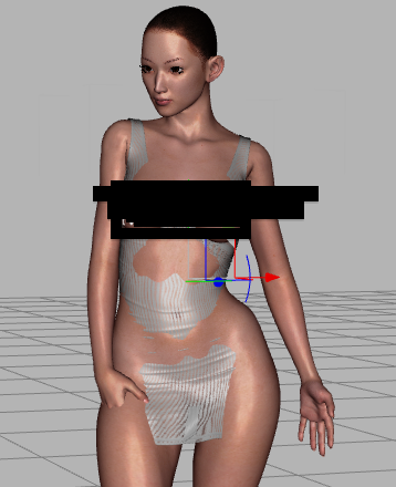

  • nokoteb99nokoteb99 Posts: 943
    Here is what happens when i try it.
    First picture is before i did the transfer Active Morphs.
    Second is after.
    Notice it really isn't doing much.
    329 x 440 - 127K
    358 x 440 - 135K
    I don't have that item to try it, can you give a link to the product?
    Do the V4 morphs appear in the clothing parameters when you apply Transfer Active Morphs? I don't know if you can use Smoothing on Gen4 items or not.

    It's this one
    http://www.renderosity.com/mod/bcs/index.php?ViewProduct=99030
    But i have the feeling even any other clothing that i try wouldn't convert properly to my morphed V4. Maybe even wouldn't conform to any other V4 morph.
