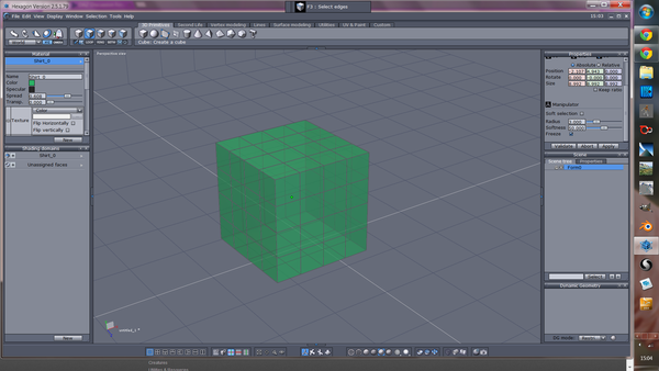

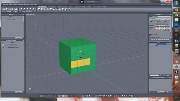

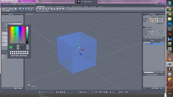

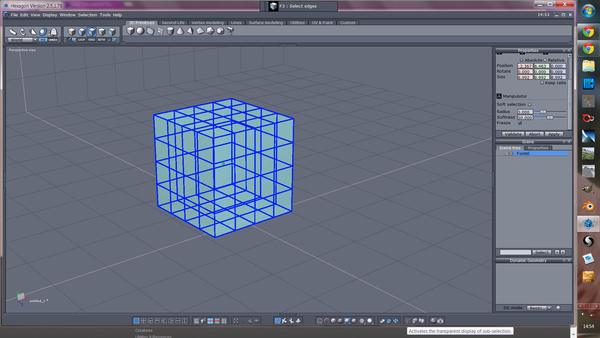

    @rol3d OK here we go. Colouring the object.
    Right, I'm using a simple cube to represent the mesh. I've also turned on transparency; not only does it look clearer but more importantly it ensures that when I lasso the object to select it I can visually check that I have selected all parts of the mesh. In this example I used the edge selection tool, I could of course have selected the faces tool. (See Fig 1).
    On the left hand side of the working window is a small arrow click this to reveal the left hand pop out panel. This as you can see from (fig 2), is divided into two halves; the top for the materials the bottom for shading domains. Dur! it appears Daz does it's own thing again; Fig 2 is the forth of the screen grabs. :roll:
    Put simply if you want to colour the whole of the object then this is done in the material panel.
    If on the other hand you only want to colour selective parts of the object with the balance another colour then one should start by using the shading domain panel.
    In the latter case click on the words which says unassigned faces. This as can be seen changes all of the object faces to a blue colour, then click on the “New” button at the foot of the panel and a new shading domain is assigned to the object as a whole. If you only wanted say three faces different from the rest then you would click on each face holding the shift key and then press new. If you are breaking down an object into different zones each with their own colour then at this stage you can click the new domain name arrow and rename it to help identify the respective area concerned. (Fig 2)
    Right, the object is blue because it has applied to the object the default colour. Say you wanted to change the colour of your shirt to green, if you click on the small blue square in the material panel another pop up will appear which will enable you to select the hue that you wish. Then right click the material description and rename it shirt. (Fig 3) Dur! The second image.
    Thus – (Fig 4). The third image
    Hope that clears up adjusting an objects colour for you. :cheese:
