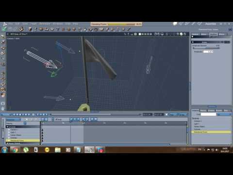

    there was a soft cloth attachment tutorial with flow force.
    cant find the darn thing
  • DiomedeDiomede Posts: 15,470
    Thank you for the "how to" flowforce.  Great idea for a thread.
    Thanks Diomede, the idea is modelled on your tutorials!
    Mistara, yes  I didn't remember that flag had flow force?
    Well directional force just as good ;)
