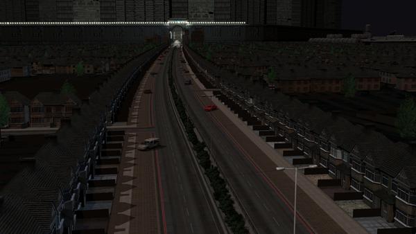

The largest scene you'll ever see on Carrara.
Sci Fi FunkSci Fi Funk Posts: 1,198
maybe .. ;-)
It is the largest I'll ever have to (probably), and it took 2 years and 4 months to plan / construct.
When I've used it in episode 8 of Sci Fi Funk (now in production), I'll do a tutorial on all I've learned about large scenes. After that I'm opting for an easier life (until the next large scene).
The scene, although dark to start with, gets lit up by the Flying taxi headlights and as we get closer to Eastgate concourse the building lights become more apparent.
Since planning this scene, I never knew if it would be technically possible. It is (just) via using proxy's and removing objects not in a particular shot.
The scene at this point is in fact 4 separate scenes merged together (Ganzill Towers in the background, Eastgate (wall) in front of it, Eastgate Concourse (the buildings in front of the wall), and the London GIS mapped buildings of Gants Hill. Plus moving people, The Taxi and a bus.
I hope you'll be kind a have a little celebrate with me :-)
1920 x 1080 - 1M

    Have you considered rendering backgrounds and spherical renders of this large scale scene for use in other aspects of your production for faster renders?

    No I haven't thought of that. Thanks!
    That might get me out of a fix when I need to render the same scene looked at from the other side..
    There can be limitations, but if you render a scene showing the occupants of the flying taxi or bus having a conversation, then a spherical render around the scene may work great.
    I used some spherical renders in the background and some regular camera renders in the backdrop of that Black Hole video I posted recently in the Post your space scenes thread. Pretty much anything with Maximillian and the astronauts was a spherical render mapped to a large sphere.
  • PhilWPhilW Posts: 5,162
    Looks impressive - congratulations! I sure hope you have duplicated / replicated all those objects, rather than loading them individually, as this will be much more memory efficient.

    It's a mixture of replication and individual objects exported via City Engine. In my opinion there is always a trade off between pure memory considerations, and time (our time) to make something. Hence I used a bit of both.

    I don't know if a shadow catcher arrangement would help somewhere as well?

    hmm. not looked into that for Carrara. I should do - would I be correct in saying shadow catching works best if the background is static?
    This is a fast moving scene as we fly from this point to the outskirts of the new city in just 30 seconds!

    Providing you can match the shadow catcher plane (or planes) to the background, it will work fine with animations as well as static images. They are most used when making a render over a photo or filmed background, but no reason you couldn't use it with your own rendered background and this will ensure that can marry the two well - although in your case, I'm not sure it would give you a big advantage doing it this way.

    I think just in this case I'm committed to rendering lights and shadows in full, as there is no background as such - it's all models.
    However I will be looking into this technique in the future. Again thanks for the technical info.
