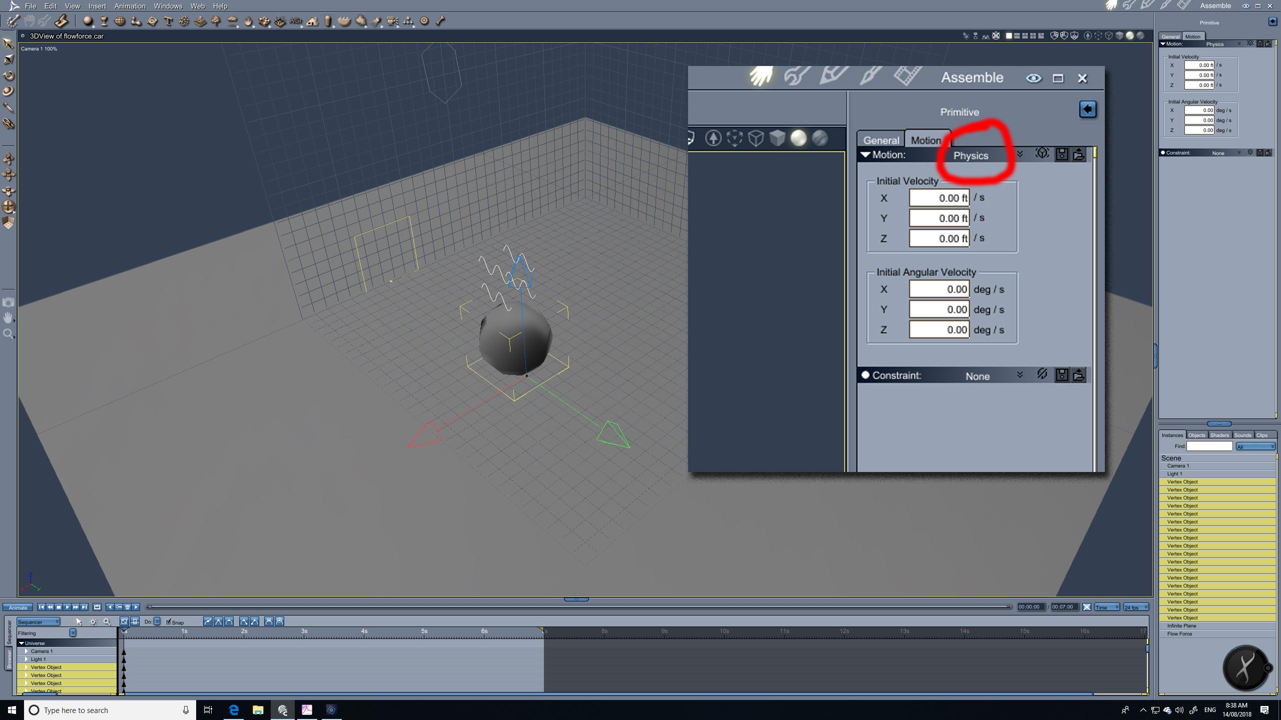

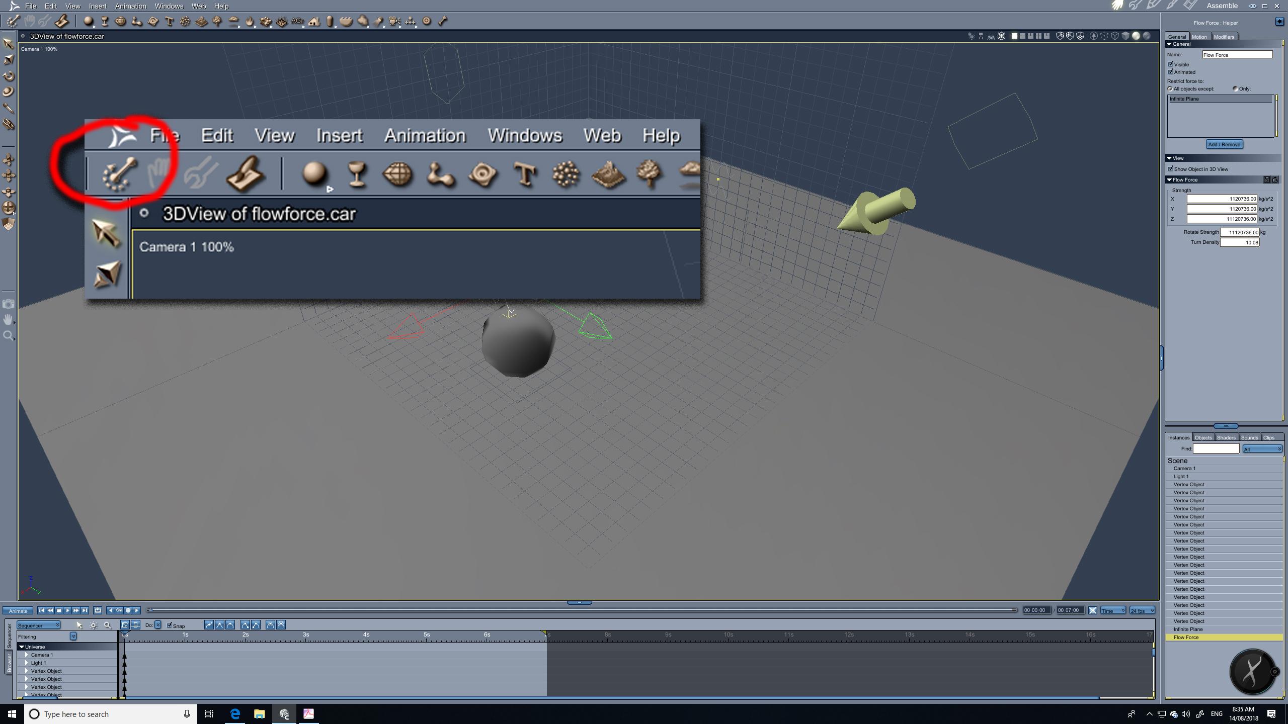

    Greetings Flash - sorry I changed the title of the thread as I realised it was ambiguos.
    Ah I don't use force but here is a brief four step rundown and simple Car file to explain.
    The Car file has several simple meshes duplicated in one spot. Their Motion method is changed to Physics (see step 2 image with red circle)
    It had an Infinite plane as the base.
    I inserted a flow force into the scene and changed the Forces so they were higher.
    I excluded the infinite plane from the physics .
    I extended the animation time to seven seconds.
    I hit the top left icon to make Carrara calculate the physics.
    The balls went around randomly. :)
    For fun I chnaged the colour of one ball so I could see what happened and then changed it's density etc (see Step 4)
    A car file is attached. For the car file you need to change the suffix from txt to car.
    As Andy says 'hope this helps'
    cheers :)

    Same Car file as above with a lot more balls. I raised the infinite plane in this one (to use as a  ceiling) and included it in the Phyics and made it invisable,
