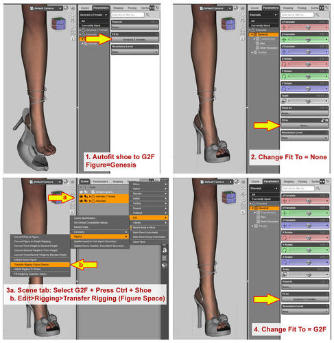

    Great news! I had put this together and will post it anyways to help someone see what the steps should look like.
    1494 x 1535 - 383K

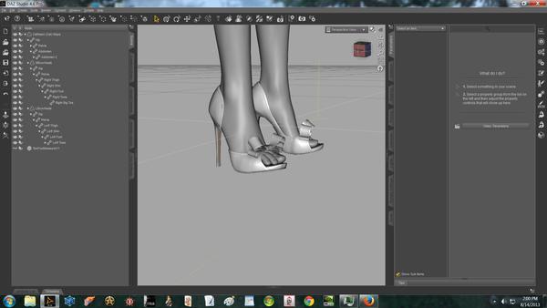

    Another set converted to G2F with this method.
    Just a know. once converted, you can save as a support asset for G2F and you have the set for her anytime. Also, I just copied the genesis mat folder into the folder where I save the G3F fittings.
    1920 x 1080 - 241K
