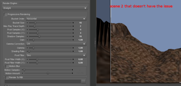

In this test scene, the edges between the polygons of my object are showing as black lines in the render. Why and/or how can I fix or avoid this? It only seems to be a problem for this one scene. I also tried to manually recreate the scene and was able to do so without problems, although obviously there is some difference between the two scenes I'm not seeing. All that's in the scene is the camera, the imported ground object, and a distant light.

    In the problem scene, lowering the shading rate to 0.5 wasn't quite enough, but it does clear up when I lower it to 0.1 . However, in the recreated scene without the problem, a shading rate of 1 works just fine and lowering it isn't necessary. Why wouldn't the shading rate work the same way in two different files that are otherwise (seemingly) identical?

    If the Item is using a Shader on the Surfaces I have seen this happen. It has happened to me for some Shaders and Lighting Combos. It will also happen with just SOME lighting. I also up the Pixel X and Y along with shading rate and that seems to help the issue.
  • srieschsriesch Posts: 4,243
    I tried reimporting the terrain using the material that was created when exporting from Bryce to see what it looked like before applying the shader, but it still has the problem (although obviously it's still using A shader, just the default one).
    Hmmm. I tried deleting the distant light and adding a new one and the issue went away, so it does appear to be the light that's triggering it rather than the material. I realized I had missed a few parameter settings in the distant light in my manually created scene, but no change after matching them. However if I copy and paste the old distant light to the new one the issue is back, so it seems to be tied to the specific settings of the light somehow. Is it possible there are some "hidden" parameter values, or are there other settings tied to the light outside of the "All" parameter list?
