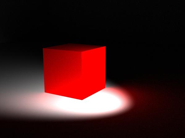

    Spyro, you can use Shader Mixer light to do what you need along with a shader mixer camera, they're not hard to set up, and you can get the effect you need.
    Red cube inside a white cube, Shader Mixer spotlight (with shadows) and Shader Mixer Camera with photon mapping.
    Oooo Thats exactly what I'm after!
    Is there a tutorial somewhere on this? I'd like to learn it :)
  • RarethRareth Posts: 1,462
    Spyro said:
    actually its even easier than I originally posted, what you need is just the IDL camera, I ran a test with just that and standard DAZ light and it worked
    just go to Shader Mixer, Click File, New Shader. in the window that opens in the drop down select Camera and name it
    right click in the shader mixer click insert -> Bricks (default) -> roots -> Lights -> Indirect Light (Camera)
    then click Create.
    nothing else needed to make an IDL camera

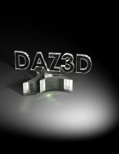

    Voila!! DAZ Caustics..
    Note: this was the sample caustics scene, I changed the DAZ Letters and Logo to Glass, tweaked render settings for a better image, and changed the photon material in caustics from glass back to chrome (better reflections back onto the plane, since I'm not trying to get refracted light through the glass in this particular scene... and it came out better.)

  • SpyroRueSpyroRue Posts: 5,020
    edited August 2013
    That is Awesome! Thank you so much :cheese:
    Even saved the IDL Cam Shader for use.
    I'll play around and no doubt post some renders soon.
    Thanks again!
    Nice glass material/shader btw

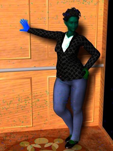

    I've had a go with the IDL camera. It looks interesting but I did have a problem with it. I sometimes get a few random coloured squares appearing on renders. But the IDL camera renders I have tried have masses of these coloured squares on them, far too many to fix with a bit of postwork.
    And the IDL camera does not play nicely with the Human Surface Shader. I tried a scene with G2F Roxi with her HSS shaders and she came out in bright colours. Is this a bug or is the IDL camera only compatible with some types of shaders on objects?
    I am attaching a render of Roxi in a lift (an elevator if you are American) done with the IDL camera and HSS shaders.
    450 x 600 - 62K
  • Takeo.KenseiTakeo.Kensei Posts: 1,303
    Use raytraced shadows on your lights. It seems you used deep shadow maps
  • Peter WadePeter Wade Posts: 1,699
    Thanks for the tip, Takeo.Tensai. Using raytraced shadows got rid of the coloured squares. It also fixed the textures on Roxi which I wasn't expecting. I don't see how changing the way the shadows are worked out would affect the light being reflected from the objects. But then using a shader mixer to create a camera seems weird to me. It just shows that I don't really understand this stuff very well.

    Its all new to me in regards to the shader mixer... Check out Takeo's video links, They're very informative. It also explains the bloches you are seeing in your render, and she demonstrates making it high quality so the blotches are gone. I never use deep shadow maps anymore, ray trace is far more accurate, not to mention its common for deepshadow maps to cause render artifacts especially in detailed scenes (Red, Blue, Yellow pixels all over the place) But also that Sub Surface shaders kinda require Ray Trace else you end up with strange glowing areas on the skin (notably the face)
