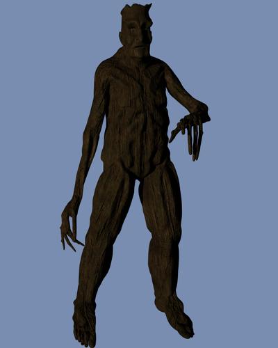

I want to make a leafy beard and hair for this Tree Sheppard morph I've made for Genesis. All I care about is how it looks with this one particular morph. Can I model my hair and beard on the morph and then fit it to the that morph so that when the morph is dialled up it assumes the shape I modelled it in? It doesn't matter if it looks like crap when it's in the basic genesis setting as long as it looks looks like how I want it to look when it's applied to this morph.

  • Richard HaseltineRichard Haseltine Posts: 111,792
