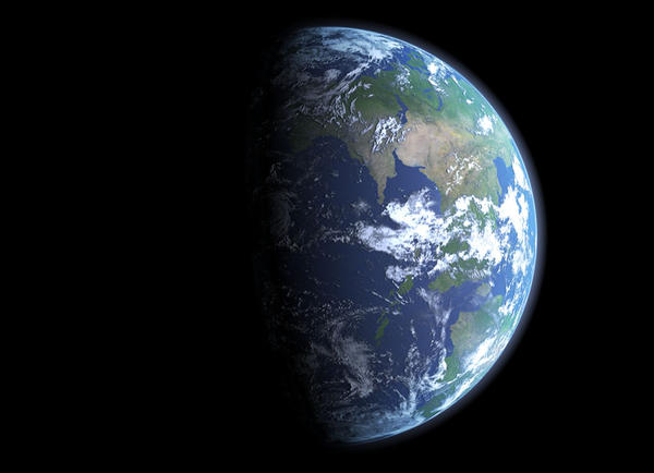

    My finished planet.
    800 x 579 - 71K

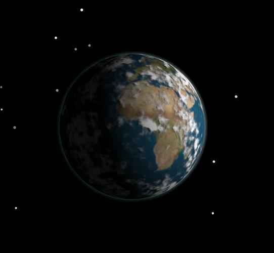

    I played around with this, after grabbing an earth texture off google. I think I fiddled with shadows too much, but essentially its 3 nested spheres, the planet is 100 units, the cloud is 102 and the atmosphere is 105 (less and it wouldn't show)
    674 x 622 - 36K
