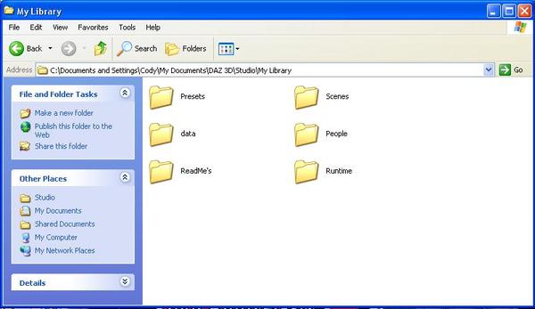

    I've tried putting it into the "Content Management Service" folder under Program Files. I tried putting it in the "My Library" folder (the one that has the "Presets" and "scenes" folders) and it still didn't work.
    The one I'm trying to add right now is the SOTO_Genesis_Flat Top. (should be on ShareCG) If it helps at all I'm using Windows XP.

  • edited December 1969
    Put the contents of the My Library folder in the zip (not the My Library folder itself) in the folder you use for content - \DAZ 3D\Studio\My Library in your Documents folder is the DS4 default, \My DAZ 3D Library in the Public Documents folder is the DIM default. When asked if you want to merge folders, say yes.
    Assuming I read that correctly, I already tried that and it didn't work. I tried putting the folders that I found inside the "My Library" folder from the .zip into my own folder and the hair style (in this case) still didn't show up.

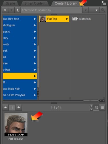

  • JaderailJaderail Posts: 0
    edited August 2013
    Then you might need to Know it will only show in the Content Library Tab as it is not Smart content. It will never load as Smart content because the needed file is not made, metadata. I installed it just fine.
    410 x 544 - 42K
    Post edited by Jaderail on

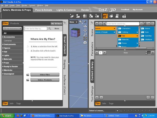

    Checked the Content Library section. Not there.
    1024 x 768 - 107K
    803 x 465 - 46K

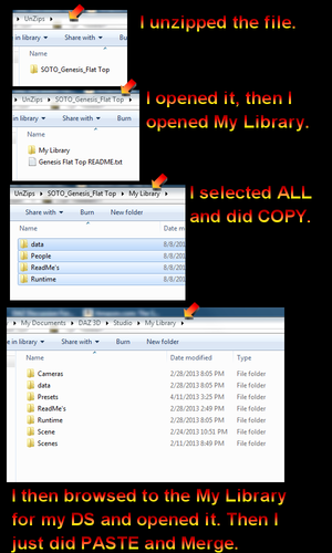

    Here is what I did on my Win7 PC. Click image for full size.
    600 x 1000 - 106K

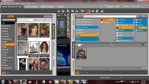

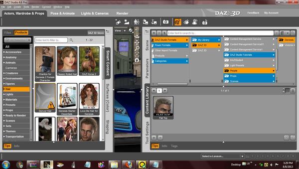

    Had the same issue myself. Found it if you go DAZ Studio Formats > Daz 3d (note- I have 2 D3D spots, choose the one that has the content management in the next box) > People > Genesis > Hair > Soto
    1360 x 768 - 161K
    1360 x 768 - 159K
