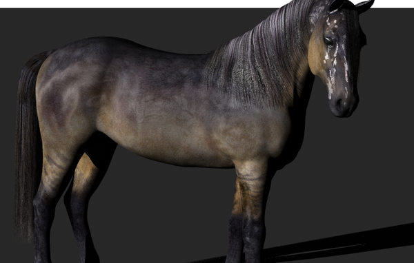

Hello to all; This is the horse 2 ...I took him apart because when he imported with his maps the specularity was set at 100 and he was spotty so I ungrouped and started changing him piece by piece but there are a few parts on his face I am unable to highlight is there a way to change him all at once inside the DTE or the maps...any ideas would be helpful....Thanks in advance ...Trish

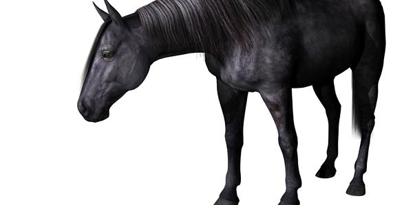

    used the bridge - looks OK to me
    what you think ?

    I see - any way I fixed it in DS before using the bridge .
    Yes it does appear that the Gen 4 figures and other figures of that era work better using the bridge than do the newer genesis and similar type models. Horse 2 is built using the same technology as the Genesis figures

    I didn't use the bridge I exported it out of daz as a wavefront obj. I do have to admit that the mane and tail on this horse looks a lot better than the old mill horse......Thanks everyone I may have to invest more into this horse

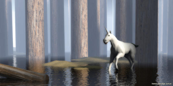

    Trish, I also do a lot of what David described whereby you go through every component and assign it a family group. It does take time and can be fiddly, but it pays dividends later if/when you edit the materials (which I nearly always edit the heck out of).
    My horse didn't turn out too well (it's just the horse that comes with Poser and as far as I remember, you can't change it's face shape which would have been nice as it's a bit too chunky to be unicorn really). :)
    1000 x 500 - 166K
