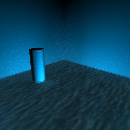

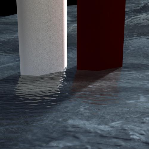

    I don't have the set you're trying to do this with, so I can't reproduce it in testing.

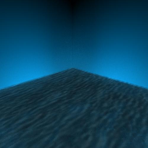

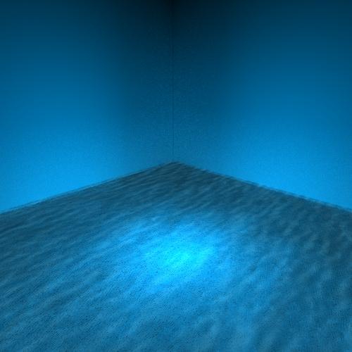

    This is just 2 cylinders, one white, one red. First Bastion's Breaking Waves, with his shaders in both the water and the dark underwater area.
    The first image has 2 point lights, one between the columns above the water and one below, and a UE2 sphere set to GI Bounce Light.
    The second image still uses the UE2 GI Bounce, but uses FB's included light setup instead of point lights.
    1000 x 1000 - 541K
    1000 x 1000 - 285K
    Post edited by Lissa_xyz on

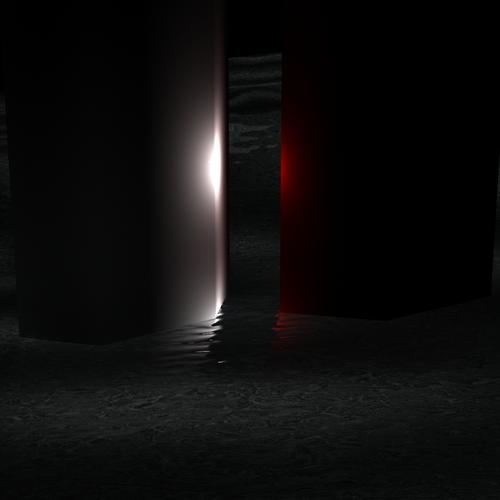

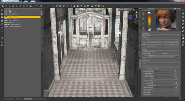

    Here's another test, without an uberarea, and the scene view to show it. All 3 lights are linear points and the far rear one has a falloff end that extends beyond the camera. I added and scaled just a basic plane and used FirstBastion's water shader on it. You can see the red checkerboard pattern from the floor just slightly through it. There is UE2 sphere, with the environment sphere part hidden and it's set to Bounce. As you can see, I am getting a somewhat lit area along the bottom of the walls where it meets the water, which is most likely caused by a reflection of the wall itself.
    Keep in mind that multiple dark surfaces most likely won't color bleed onto each other, either. I get better results with lighter surfaces accepting colors.
    This was the only set I could think of offhand which mimicked an enclosed space with a door. lol
    The render itself is using the 'proof' setting from AMR's render settings scripts, and I knocked up the ray trace depth to 4 for the hell of it. lol
    I did load an uberarea, but just to get that headlamp blocker- I deleted the actual light.
    1920 x 1050 - 392K
    1000 x 1000 - 645K

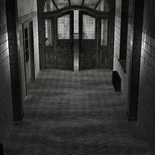

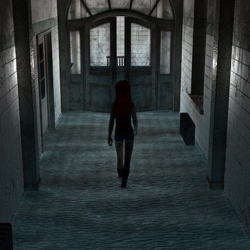

    Geezus I'm an idiot. There's a 'glow' shader in the shader builder that can be used easily to fake this. I forgot about the builder.
    Forget the uberarea under the water, delete it, call it plenty of names as you kick it's butt out the door. lol
    Create a plane just above the water surface, and select the plane in the surfaces tab.
    Now go to Window > Pane > Shader Builder (not Mixer)
    Extend Surface and go to Renderman Companion. Right click on Glow > Apply to selected surface(s).
    The higher the attenuation, the less the amount of glow is produced.
    Opacity just makes the glow more see through.
    You do still need the UE2 set to bounce for this to work properly, otherwise everything comes in really dark.
    I set the diffuse color of my water and the glow plane to the same color just so they blend together easier.
    I also put the raytrace depth back down to 2. Putting it on 4 was killing my render time on the hair area.
    In my shot, none of the glass in the doors are shaded with glass shaders, either. So I'm not getting any reflections/light bouncing through them atm.
    1000 x 1000 - 616K

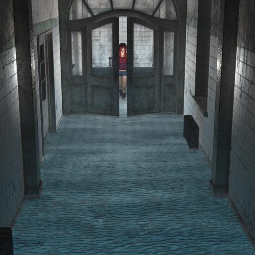

    Same scene using AoA's Atmospheric Cameras (the fog) with the haze setting. Moved the girl behind the rear pointlight too.
    Since the camera introduces the haze, the water is really brightened up as the lighting is bouncing off of the haze effect also.

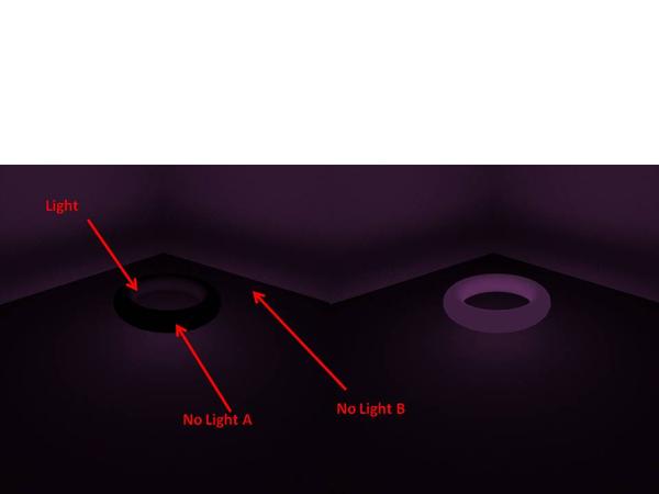

    Ok, wow. This water is resistant to everything for some reason. I decided that to get the best effect, I should probably have a 2nd water, opacity turned all the way down, and try and slap on the urban area light.
    Here's what I did:
    I selected the 2nd water, and went to the surfaces tab. I expanded what I could, and clicked on Diffuse on the left side of the pane. I then held down ctrl, and double clicked. I made sure that the pop up window said "Selected" and "Ignore". I ended up trying it multiple times with it saying "Replace" and still got nothing.
    I had changed the parameters on the Diffuse strength to go as high as 50,000, and even had it turned all the way up and didn't get any results. I also adjusted the Intensity to be the same, and still got no where.
    I turned Fall Off On, made sure it didn't go higher than 50, changed the shadow color to a dark grey like recommended and made the Shadow Intensity to 90%. Because the Diffuse Color also has a map on it, I even tried removing the map, changing the color, and still didn't get anywhere.
    Just to make sure my uberarea works, I did it with a torus, and I saw something interesting. Only the inside of the torus lights up. The outside doesn't.
    So my question is how do you reverse this? I'm wondering if the water is the same thing. The water might be a similar type mesh where it lights up inside the water, but the light doesn't project outwards.
    Thoughts?

    Ok, I think I see where the problem is here. I think it's been my lack of proper vocabulary. So let me start over.
    I'm wanting to take the water and have it emit light in all directions. Similar to a linear point light where the fall off can be controlled. The goal is when a model is standing in the water, the model has light coming from the bottom, but at the same time, the water's light extends to the banks/shore.
    Fall off - I did not know that it was measured in cm. This makes total and complete sense now.
    Torus - what I did was create a box that was 5mx5mx5m. I placed a 2m torus inside the box and placed a camera inside. I kept the box white so that I could notice any light that would show up. After that, I added the uberarea light to the torus. You're right, the center space did have light in it projected from the interior of the torus when I increased the intensity of the lighting. However, the outer portions of the torus and along the base of the cube, even to about halfway up the cube's interior, remained dark. So I'm wondering how to make the entire torus emit light?
    Am I making sense now?

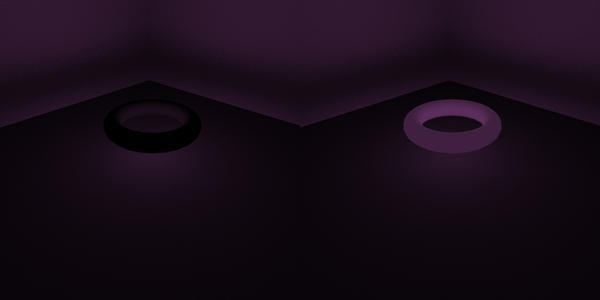

    edited August 2013

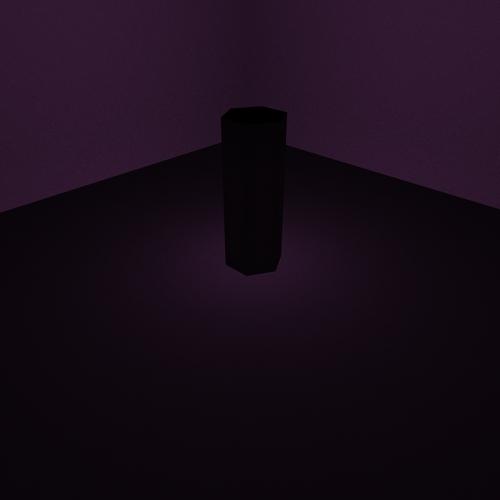

    I see what you're saying, as I'm getting a black band around the box. I'm not sure how to fix that other than turning shadows off on the uberarea completely.
    For the image on the right though, I set it the ambient color the same color as the light and turned the ambient strength down to 50%.
    1000 x 500 - 169K

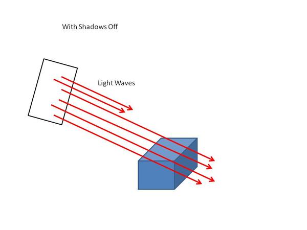

    edited August 2013

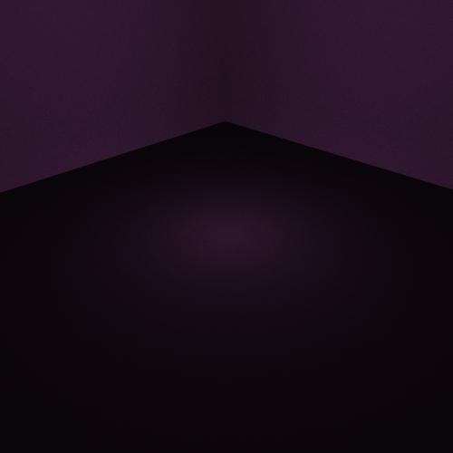

    Fantom ON, Shadows Active OFF
    Problem with this, is nothing in your scene will throw shadows on the walls, either.
    500 x 500 - 86K
    500 x 500 - 86K

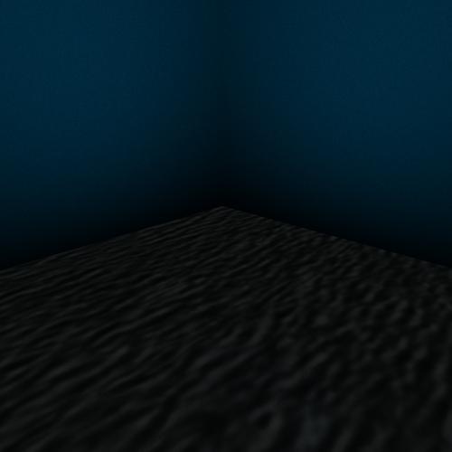

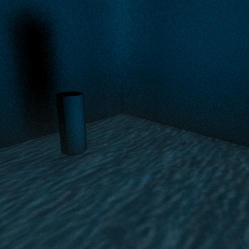

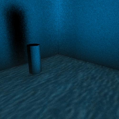

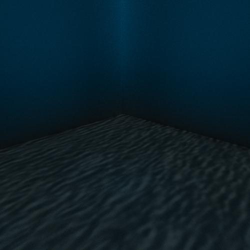

    edited August 2013
    Try an area light disc, scale it as necessary, and set X-Rotate to 180 so it points upwards.
    Here's a cube, an uberarea disc, and a plane with a water shader. The disc is 1 point above the ground, the plane is 15. I turned fantom on, and raytracing and accept shadows off on the uberarea disc so it wouldn't interact with the scene (I've seen to turn those off with invisible uberarea lighting).
    I didn't bother changing the color of the water, but the disc is completely submerged under the plane.
    500 x 500 - 105K
